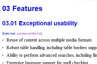

The "Styler way" is to style up your divisions as appropriate, ...
Resulting in ...
Once the numbering is configured for the main body display, you then call that numbering into your footer using Generated Text. Insert -> Division Reference. Select the division to call in (first or last on page) and it will then display with correct number format (leading zeros).
