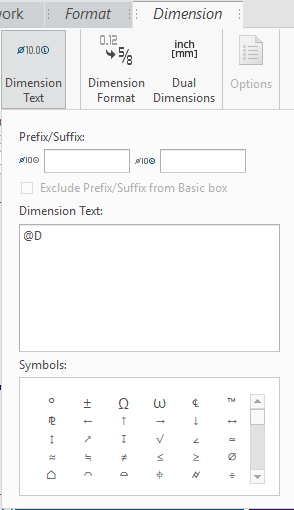

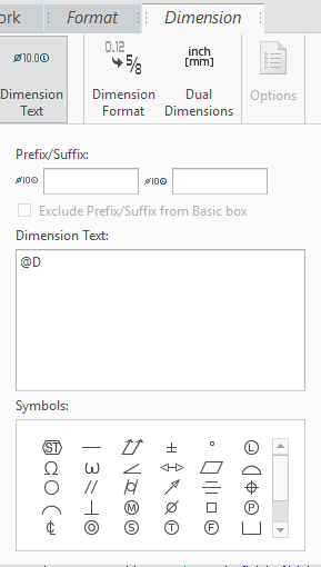

Can anyone help me identify the path to the file containing the symbols for dimensioning?
I recently got a new pc and therefor reinstalled Creo4.0 M030.
On my old pc the symbol palette looked like this:
OldOld
On the new pc it looks like this:
NewNew
As you can see I now have other symbols in the palette but also especially the diameter symbol "Ø" is significantly different and it stays different when I print the drawing as a PDF.

I think earlier you were using drawing option symbol_font as legacy in drawings and in new it is asme.
If you will change the symbol_font drawing option in drawing to legacy, you will get old symbols.

symbol_font is drawing option.. set it as legacy in respective .dtl file.
