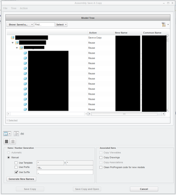

Hi There,
I am looking to do a 'save as' on a large assembly to allow me to change certain aspects of the assembly (replace a few parts/relocate some other sub-assy's) without affecting the production-standard assy (that my colleague is working on currently). Whenever I do a File>Save As, it says 'Mirror component **new_name_I_gave_it.asm** creation aborted', followed by 'Select parts or sub-assemblies to copy' and brings up the new name generation window, with the 'save copy' button greyed-out.
As there are best part of 7000 parts/sub-assys, it seems absurd that I should have to create duplicates of all of the children as well, when all I require is an identical assembly to this, with a different top-level name (no different to doing a save-as on a word doc).
Any help on whether it is possible to achieve a conventional 'Save As' would be greatly appreciated.

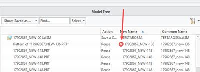

I just looked at your screenshot. The ones that say reuse aren't requiring you to give a new name but it is an option.
Only the ones that have the little red 'x' are requiring you to give a new name.
