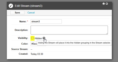

Thank you so much! The "Hidden" feature is an excellent workaround. When using it, a message appears: "Hiding the Stream will place it into the Hidden grouping in the Stream selector."Is there a way to view the "Hidden" grouping and restore previously hidden Streams back to visibility?
GeoffreyClemm
(To:juwang)
In your user Preferences, under Stream Settings, you can specify whether you want to see hidden streams (default is "no").
Oh wow, it’s right here! Thanks for your answer!
