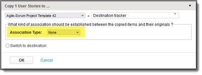

Hi @CM_9399659 , I could not find any way so far to achieve this on Codebeamer out of the box. For example, there is currently no way to get associations via computation and I see no default workflow that could catch / keep the count of the operation. Once the copy is done, no more information about the operation is stored in Codebeamer, unless you explicitly set the Association Type. To complicate things:
- There can be cases where a copy is done but "None" is chosen as Association Type:
In that case, the copied item will not have a link to the master
- The opposite is also true, one could manually set a Copy association between two items that have nothing in common and have been created separately
- The Summary can be edited later, making a report based on the title equality unreliable.
