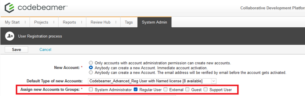

I am configuring SAML SSO in Codebeamer. I Would like to allow sign up SSO and it is ok. But these new users created automatically with SSO in which gruop will be insert in? Regular user? External?
Thank you!
You configure which group(s) a new user will automatically be assigned to. Under System Admin --> User Registration you will see the checkboxes as below:
3 REPLIES 3
if someone register himself with SSO and in "User Registration process" I checked just Regular User, he will be a " Regular User", right?
Thank you!
Yes, any new user should be part of the group(s) you specified.
