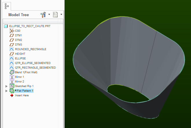

As others pointed out, blended sections can be developed into a flat pattern provided that the formed surfaces are not twisted.
The example ellipse to square transition, (or rather rounded square) is presented here:
Examine the attached model (Creo 2.0). By manually constraining the sketch entities, I ensured that edges in the rectangle 1/4-section are parallel to corresponding edges in the ellipse 1/4-section section. There are a lot of variables as to what spacing between the vertices should be and this can be optimized but Creo just does not have an automated way of blending sections by "developing" / "triangulation" techniques (Solidworks does). The method presented is by no means "easy to use", and the resulting model is rather rigid and brittle.

You missed the key aspect of the process: approximations of your curved sections using straight line segments!
And then imposing the parallel constraints on the corresponding straight edges of the two sections...

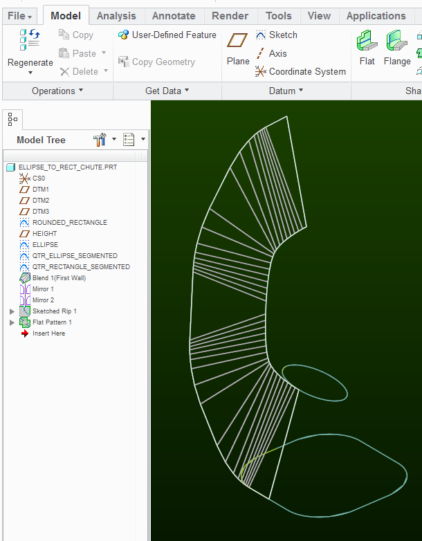

Hi Paul, I have tried again by the method. I really missed that point. But now I have been able to unbend half. Why is it not fully unbend? I have attached the model.
With regards,
Soumya
The problem is in Sketch 3 - two of the segments have the parallel constraint on them. The rest don't and so you don't get the fully flat un-bend...
Try to make every set of edges parallel, like this:
This can be tricky. One thing that helps is to remove the coincident constraints at the two ends of the round in the square section. Good luck!
