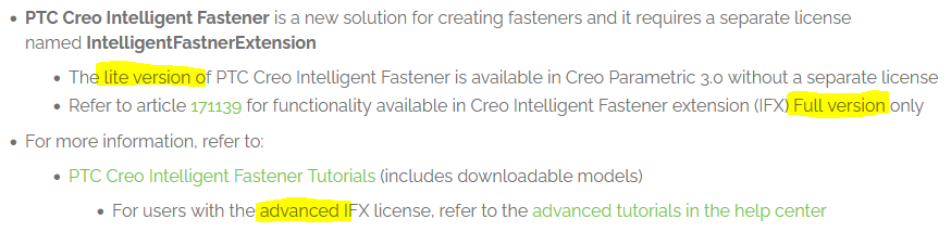

@Dayna_M,
Can you please clarify what is meant by "New license packages includes IFX, older ones require a separate license"?
Do these new Creo license packages automatically include the "full IFX license" now or are you simply talking about the "light" or "free" version that has been bundled ever since Creo 3.0?
https://www.ptc.com/en/support/article/CS180439
Thanks.
Sep 6, 2021 6:44 AM UTC
Hi Tom,
I'm not Dayna (;)), but some time ago I asked the very same question and I was informed that (and verified that in Creo itself), that all the new Creo Design packages (starting with the base one Creo Design Essentials) indeed include FULL version of IFX, as well as Design Exploration, Cabling/Piping, Manikin (Human Factors) and Render Studio extensions. So with the new packages you get the full functionality of IFX, for pre-Creo Design packages you'd need to purchase a standalone extension.
