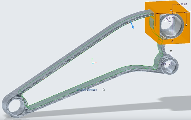

When you create a 2.5D lattice, the first step is to select the references that will enclose the volume.
You can use any method in Creo to select a closed volume.
Selecting a closed volume.

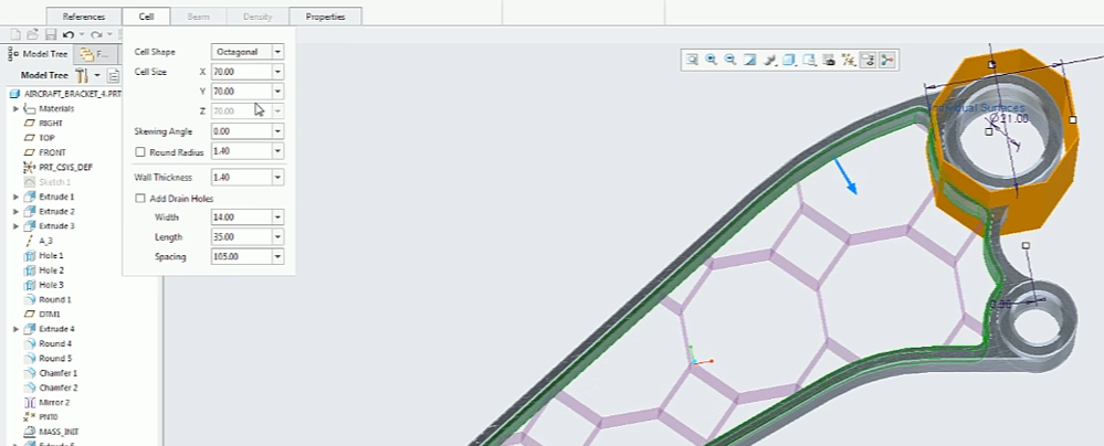

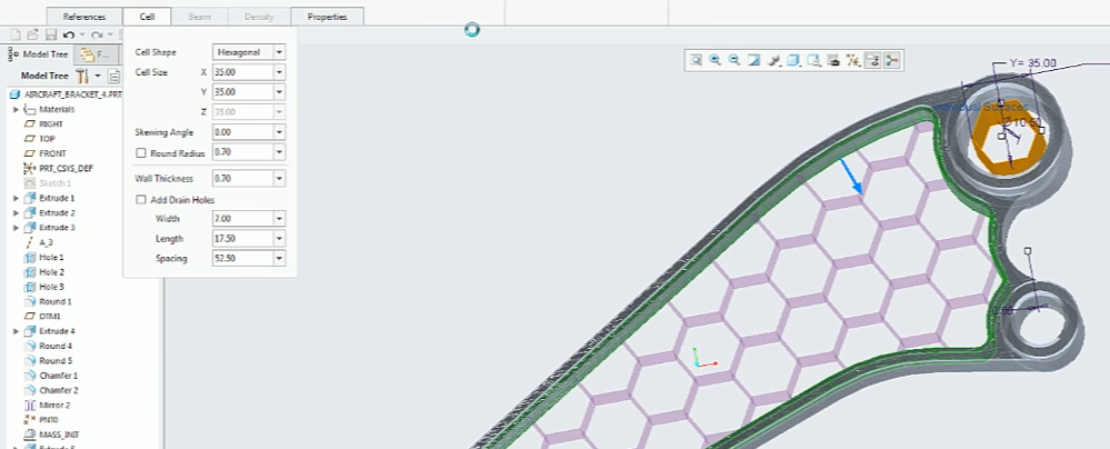

Once you have that, then you define or select the cell. The cell types available are triangular, square, hexagonal, and octagonal.
In the cell dialog you can modify the cell size and other parameters like wall thickness, etc.
An octagonal 2.5D lattice.
We can see on the screen an octagonal 2.5D lattice. When you change it to hexagonal it becomes a honeycomb. You can select a modifier to reduce the size in half.
Changing the lattice to hexagonal and reducing the size in half.
When you modify the wall thickness, you can see another example of a honeycomb 2.5D lattice.

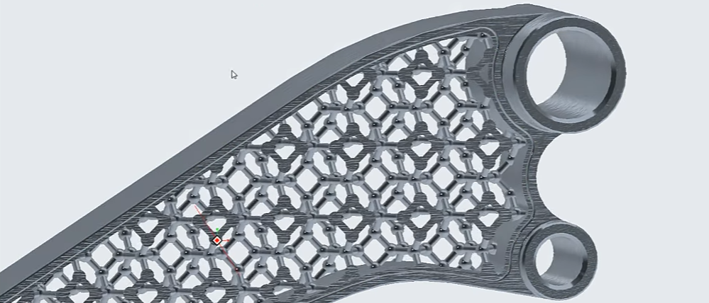

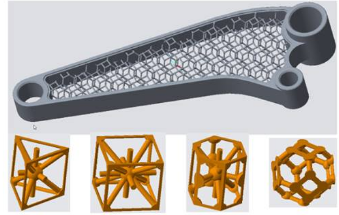

The second cell type you can see in Creo 4.0 is the 3D lattice.
Let's look at an example of the 3D lattice. You will see it that the 3D cell is based on beams.
You can also select triangular, square, hexagonal, or octagonal.
On the Beam tab, you can define if the cross-section type is circular. The cross-section size is the diameter of the beam, and the ball diameter will be the connections between beams.
A 3D lattice is made of beams.
Look at the result of this through the lattice creation. This describes the basic notions of lattice creation.

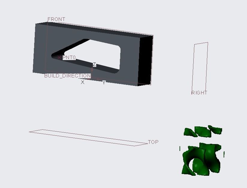

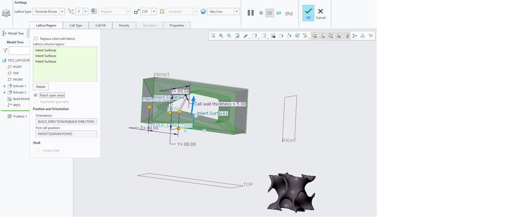

    We currently try the new features from CREO 6.
    But we can't get a result.
    Before:
    imageAfter:
    Do you know why the lattice geometry just stays down there and gets flawed?
    Regards
    Nov 14, 2019 12:56 PM UTC
    It's possible the bounding surfaces have not been defined correctly. Please refer to https://www.ptc.com/en/support/article?n=CS253403 where it states "The Bounding Surfaces option requires a closed volume of references". Typically, if the bounding surfaces are not correct you'll get a warning "Failed to merge volume boundaries."
    It's not entirely clear from just the screenshot, but I would suggest adding the "front" and "back" surfaces to the bounding surfaces collector. If you've already done that or that does not work, please upload the model.
    Mike
