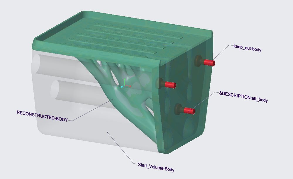

Example:
All bodies have a DESCRIPTION parameter called out using &Description:att_body

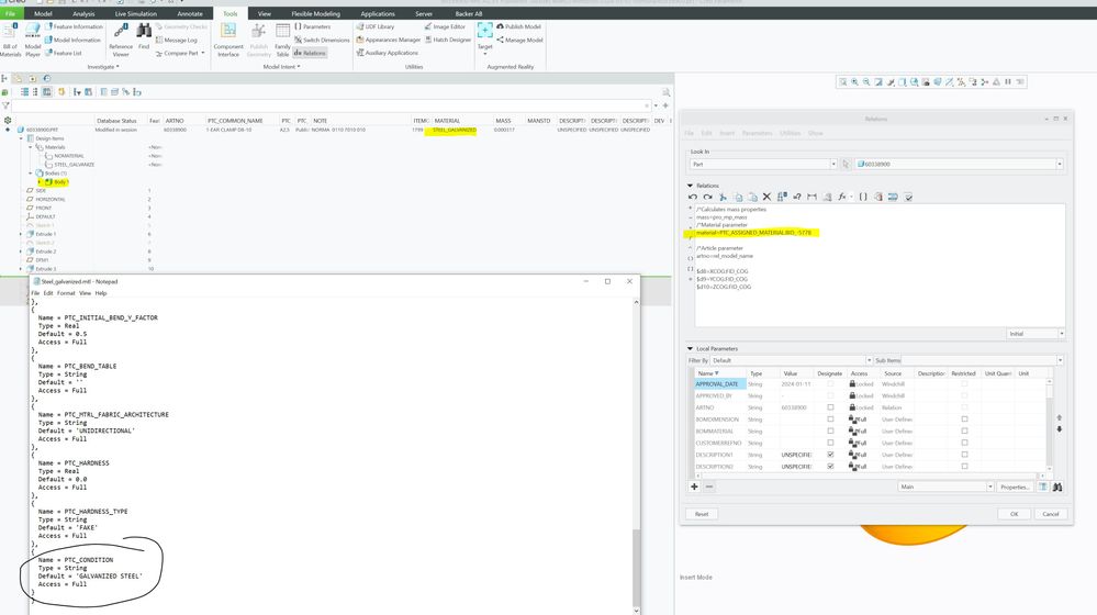

I have the same problem as @mstols mentioned.
If you could help @mneumueller  this would greatly help.
I'd like a startpart ready for single/multibody. Building on the old startpart logic, i'd like to be able to pull material names in with a "clean" description.
for 1 body i'd like the resulting string in the value field to be
GALVANIZED STEEL (not galvanized_steel)
for a multibody i think I need to work with table repeat regions instead, to look something like this:
 (User defined body name)(PTC_CONDITION)(... any material file parameter)
layer 1 Cool green material...
layer 2Super blue material...
March 7, 2024
Unfortunately that is not that straight-forward as there is no relation support within bodies.
Otherwise you could have just created a body relation to call  the above function.
So, currently not really supported.
But: If you know upfront how many bodies you need and create them as empty bodies in the start part (so you have their Body IDs) you could of course create part-level relations
MATERIAL_1=material_param("PTC_MATERIAL_DESCRIPTION",PTC_ASSIGNED_MATERIAL:BID_-5778)
MATERIAL_2=material_param("PTC_MATERIAL_DESCRIPTION",PTC_ASSIGNED_MATERIAL:BID_xxxx)
and then assign a parameter to each body holding
body 1:   MY_MATERIAL = MATERIAL_1
body 2: MY_MATERIAL = MATERIAL_2
and then call out the body parameter &MY_MATERIAL:BID_xxxx
But yes, this is limited to situations where you create the required bodies as empty bodies upfront in your start part.
