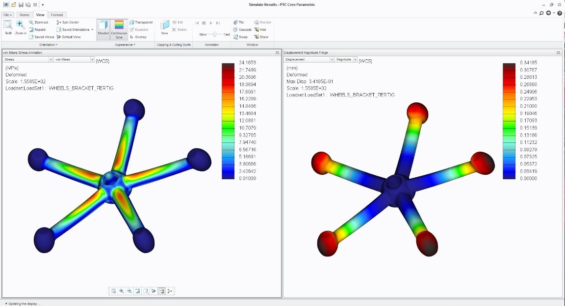

However, the biggest influence behind the spread of FEA into a wider community has been the improvement of the user interface. This is most dramatic in the FEA products which are embedded in CAD programs. Instead of fighting with arcane syntax and data structures, the workflow is laid out in a very familiar CAD like environment.
 Simulation available from within a CAD tool
2017: Simulation now available on desktops as part of Creo 3D CAD package.
