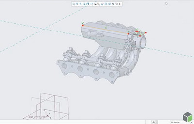

  • Quickly defeature a model to prepare for simulation.

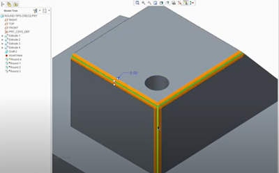

  • Creating advanced rounds.
imageAdding rounds

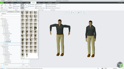

  • Store and apply Manikin custom postures.

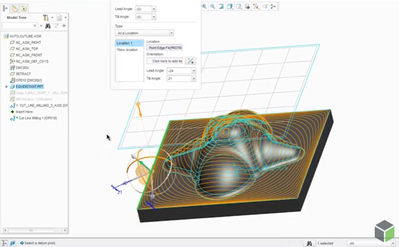

  • Using the Manufacturing module, drill holes in Creo without creating an axis; plus use the Auto Depth option.

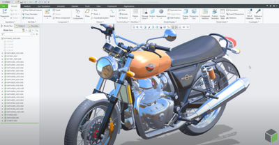

  • Use simplified reps to publish only what is needed in an AR experience.
  • Use Sketch Region selection to quickly create geometry with supported sketch-based features.

  • Add ancillary objects to Manikin models.
  • Display the toolpath and its references by clicking on the toolpath name on the Model Tree.

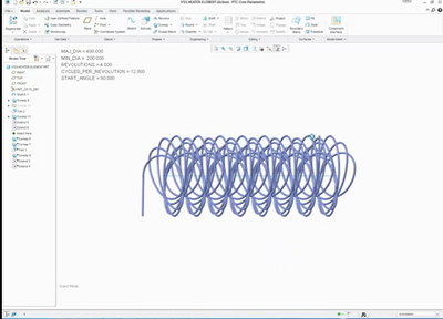

  • Build spiral geometry using a variable section sweep and a parameter called TRAJPAR.

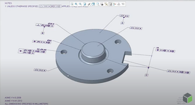

Post 8
  • Report mass properties for each wire in a BOM.
  • Create a helical toolpath using the auto-cutline functionality; plus, define a 5-axis toolpath while controlling the tool axis.
  • Prevent inadvertent modification of driving dimension values when the dimension precision (number of decimal places) is modified.
