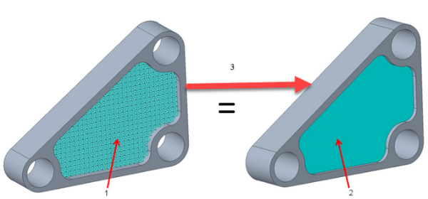

Say the number of cells in a structure exceeds 24,000. You may find it impractical to store or simulate full or simplified geometry models of that size in your system. These tasks simply require a too many computational resources. To facilitate the modelling of large lattice structures, Creo can now represent them as a continuous solid with material properties equivalent to those of the lattice structure.A solid with these effective material properties will have the same mass properties, stiffness, porosity, etc. as the original lattice structure.
Image: Creo 6.0.0.0 uses homogenization methods to facilitate the modelling of large lattice structures by computing and providing Creo Simulate the equivalent homogenized material properties. 1. Lattice structure; 2. Homogenous Continuum; 3. Process of Homogenization

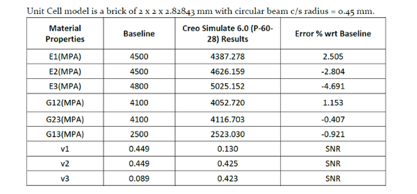

The Data: How Do the Results Compare?
We compared Creo 6.0.0.0 results for three lattice structures and all of them compared very well with baseline. The homogenization results converge when compared with full lattice geometry models. As you can see in the table below, the error declines with an increase in the number of lattices in a given volume.
