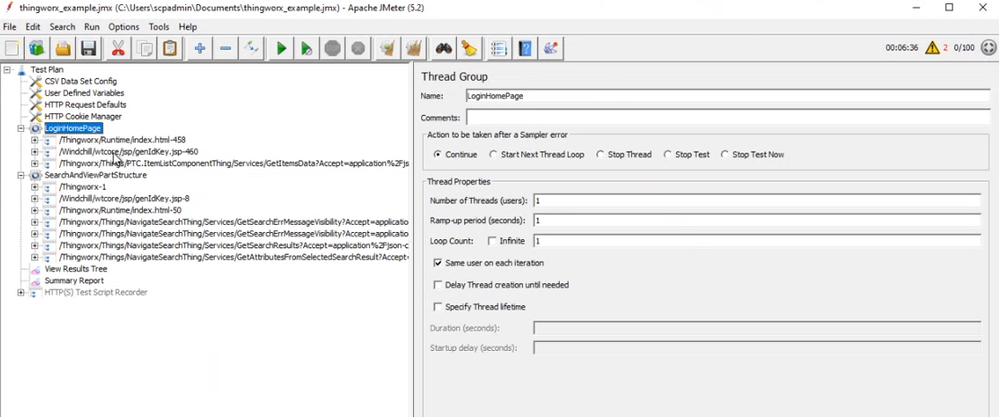

- Start by renaming the existing thread groups so that their process or procedure names are recognizable at the end of the test:

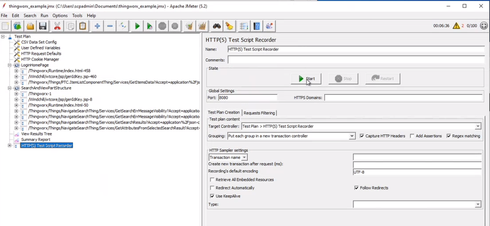

- Highlight the line which reads “HTTP(S) Test Script Recorder”. (Optional) Add an Include filter to only capture the URLs relevant to your application using the Requests Filtering tab. For example, with the escape character \ necessary for ‘.’, myhost.mycompany.mydomain becomes: myhost\.mycompany\.mydomain
- Now record a new thread group clicking the “Start” button:

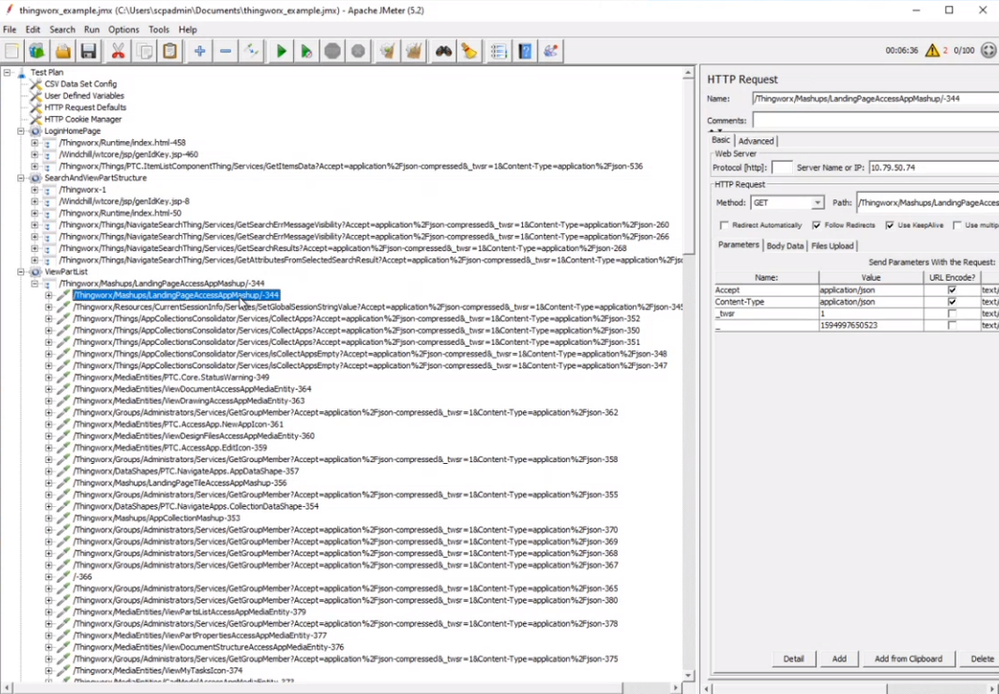

- All of the HTTP requests performed in the process of loading and using this mashup will be added to the JMeter project here:

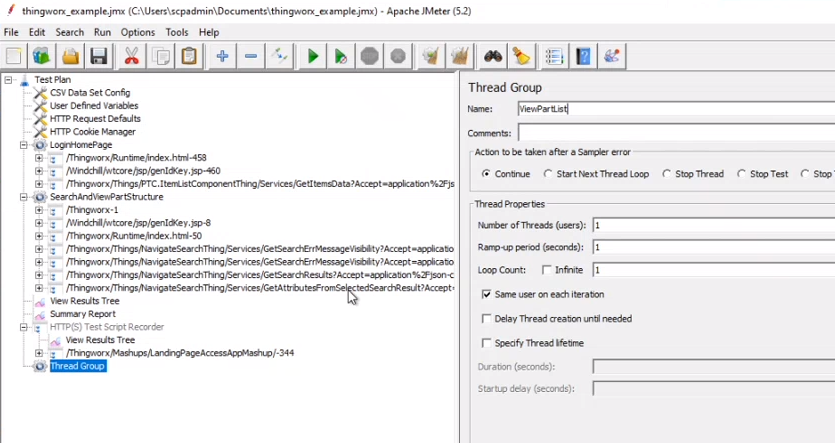

- Next, add a new thread group manually to the project:
- Highlight the newly created “Thread Group” (default name) and rename it to something that relates to the nature of that process:
- Drag and drop the new collection of requests so that it is considered a part of the new thread group:
- Then drag the whole group up so that it is next to the other thread groups in the test:

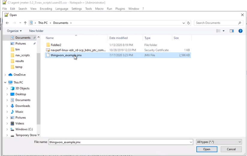

- In more complex projects, different thread groups may be added at different times, and each time, the service calls are all assigned an index (at the end of the request URL, for example: <request>-344). These indexes may not be unique depending on how and when the thread groups were created, especially in more complex tests. The easiest way to fix this issue is save the test from the JMeter GUI, then open the JMX file in a text editor and perform a find and replace within the relevant section of text.
This is usually done using a regular expression for the number. For example, if the request name indexes are numbered -500 through -525, a regular expression to increase them to -700 through -725 would be (in Notepad++):
Find: -5([0-9])([0-9])
Replace: -7\1\2

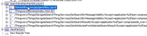

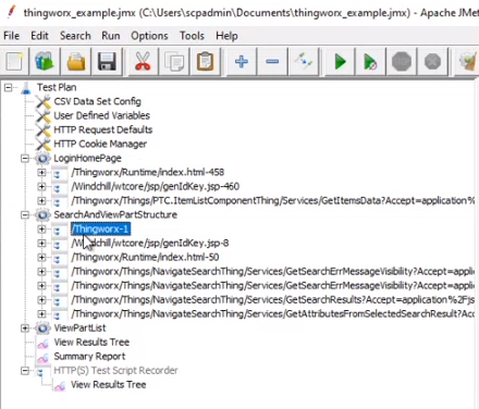

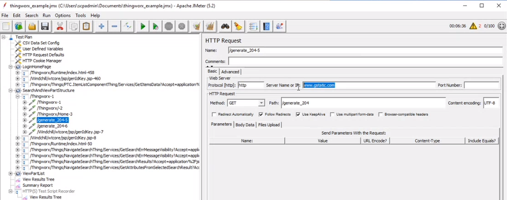

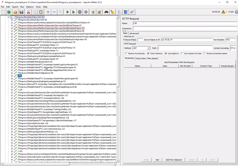

- Note that if you do not use a Request Filter, sometimes the recorder will log URLs that are not part of the target application, like these “generate” samplers. These URLs are typically happening in the background of the browser to track performance, security and errors. These can be deleted:

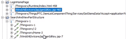

- At other times, you will be repeating steps that are already part of another thread group, for example: logging in. This genidkey is a part of the login, as you can see if you look back at the login thread group. Because logging in is only necessary once, and it is assumed to be complete by the time the test starts on the second thread group, this entire section can be deleted:
- To see for sure if a request can be removed because it is called in a previous thread group, do a non-case-sensitive search for the name of the request:
- All of the requests found in this particular instance were performed in the previous thread group, so therefore this entire category can also be deleted:
- Another odd thing you may see (if you do not use a Request Filter with the recording feature) are “blank” requests like these:
The recorder isn’t sure what to call these “non-requests”, so anything like this that isn’t an actual URL within the target application should be deleted.

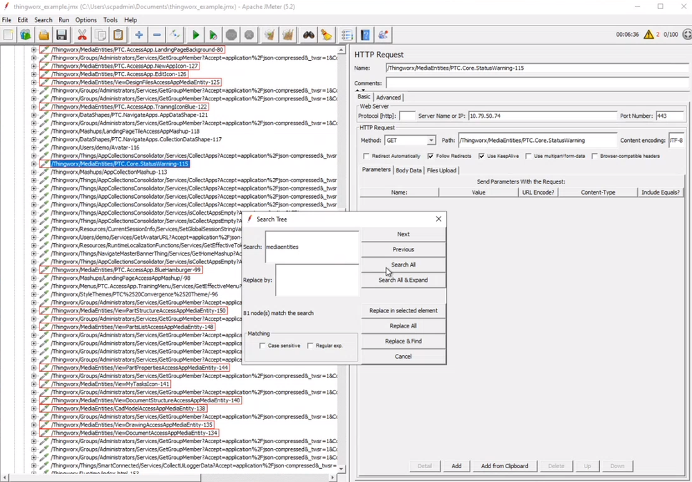

- Static downloads should be disabled or deleted from scale testing since they are usually cached by the user browser client. In this ThingWorx example, there are static “MediaEntites” which can be deleted or disabled:
Within the JMeter client there is no good way to highlight and reset them all at once, unfortunately. The easiest way to remove all of these at once is to open the JMX file in a text editor and use regex expressions for search and replace “enabled=true” with “enabled=false”.
Most text editors have examples on how to use regular expressions within their Help topics. The above example is for Notepad++.

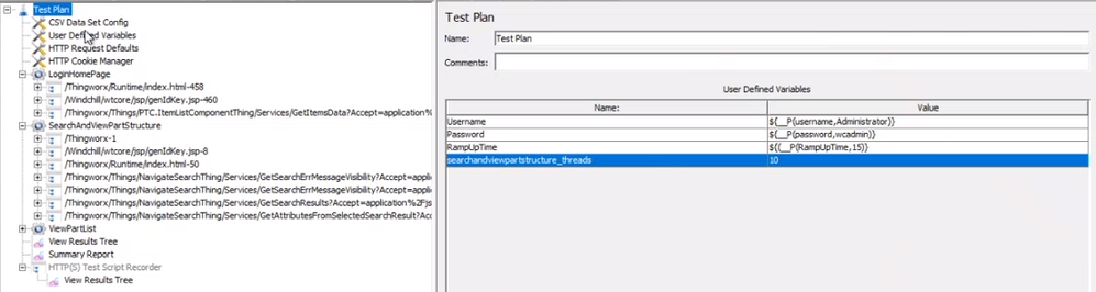

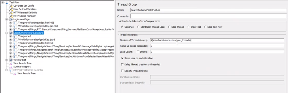

- Start by selecting the new thread group and parametrizing the number of threads (i.e. the number of users accessing this mashup at a time during the test). The way to enter a variable is with syntax like this: $(searchandviewpartstructure_threads)
- In this case, make this a user defined variable:
or a variable for the whole project, by highlighting “Test Plan” and adding the information there.

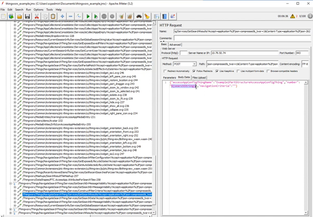

Another example here parameterizes the search parameters for a query by adding an overall search string column to a CSV file (which can then be randomly generated by some other script):
- First, parameterize the body data of the request by highlighting the request, and changing the value of the desired field to something like this: $(searchString)
- Next, define the parameter under the Test Plan and set a default value:
- Now define the searchString column again as part of the CSV Data Set:
Now it can be varied simply by providing different pseudo-random values with wildcards and/or known values in the CSV file.

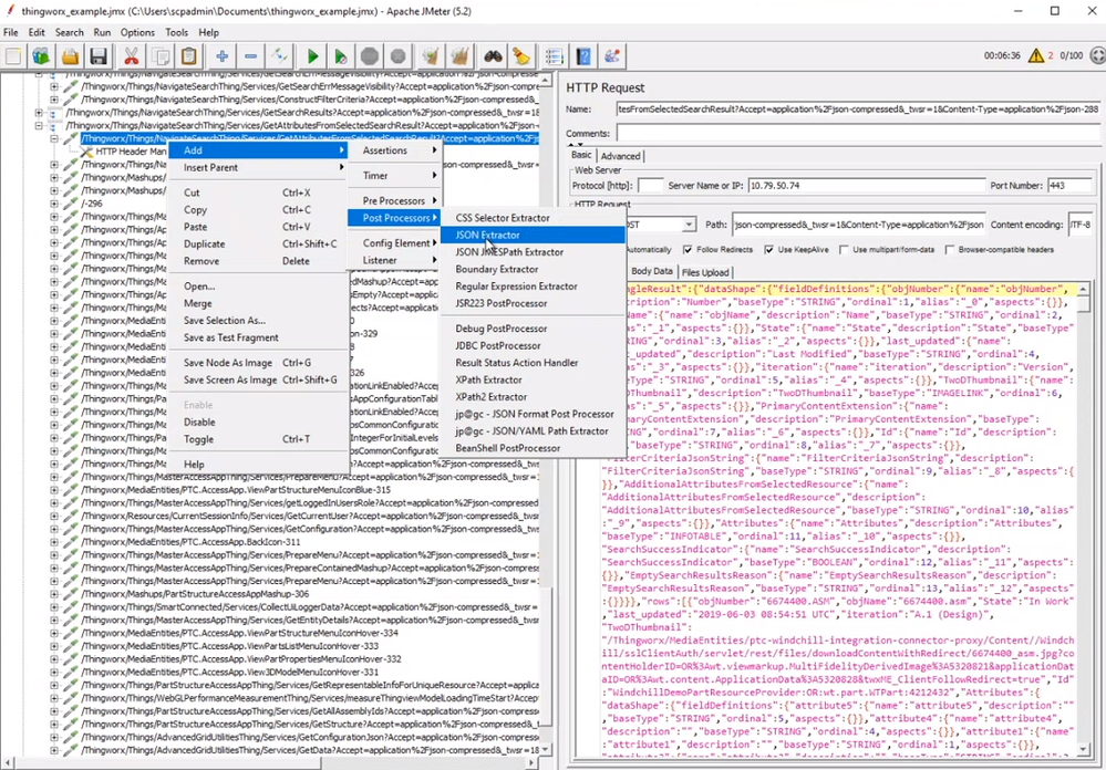

- Start by right-clicking the request that contains the results of our search. Then click “Add” > “Post Processors”> “JSON Extractor”, as shown in the image below:
- The extractor will now show up under that request as a sub-menu item. Select it, and name the variable something easy to reference. For the JSON Path expressions, pull the object number or some other identifying characteristic out of the search results: $.rows[0].objNumber for example.

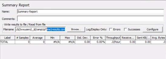

Another thing to parameterize is the summary report result file name. Adding in the number of users and ramp up time can result in files that are easier to reference later being stored on your machine. We will cover generating and reviewing Summary Reports in full in the next article in this series.
