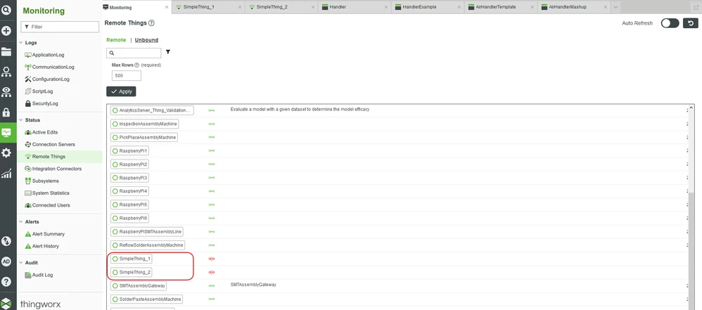

You should be able to see a Thing in your ThingWorx Composer called SimpleThing_1 with updated lastConnection and isConnected properties. SimpleThing_1 is bound for the duration of the application run time.
The below instructions will help to verify the connection.
  1. Click Monitoring.
  2. Click Remote Things from the list to see the connection status.
You will now be able to see and select the Entity within the list.
