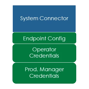

Step 4: SystemConnector Thing Template
After grouping our second set of common functionality and information, we came up with the list below for the second Thing Template to create, SystemConnector with 3 Properties. The breakdown for the SystemConnector Thing Template is as follows:

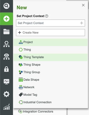

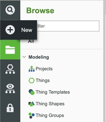

  1. In the ThingWorx Composer, click the + New at the top of the screen.
2. Select Thing Template in the dropdown.

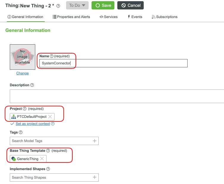

3. In the name field, enter SystemConnector and select a Project (ie, PTCDefaultProject).
4. For the Base Thing Template field, select GenericThing.
5. Click Save.

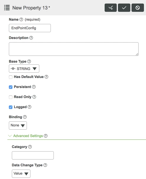

Follow the next steps for all the Properties shown in our template property table.
  1. Click Add.
  2. Enter the name of the property (ie, EndPointConfig).
  3. Select the Base Type of the proprty from the dropdown.
  4. Check the checkboxes for the property Aspects.
  5. Select the Data Change Type from the dropdown.
  6. Click Done when finished creating the property.

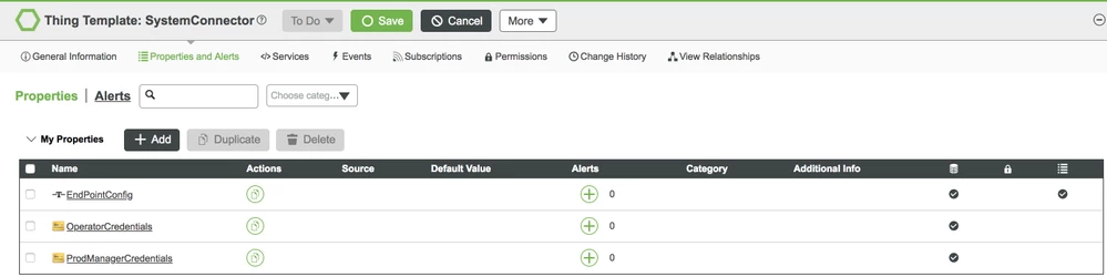

Your Properties should match the below configurations.

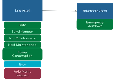

Step 5: HazardousAsset Thing Template
After another round of prioritizing and grouping common functionality and information, we came up with the third Thing Template to create, HazardousAsset. It is a child of the LineAsset Thing Template with one added Service. The breakdown for the HazardousAsset Thing Template is as follows:
Hazardous Asset Service

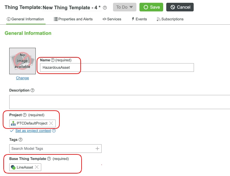

3. For the Base Thing Template field, select LineAsset and select a Project (PTCDefaultProject).
4. In the name field, enter HazardousAsset.
5.  Click Save then edit to store all changes now.

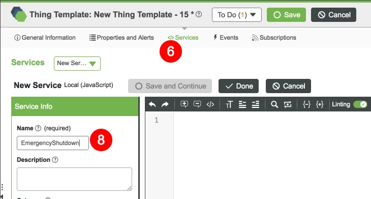

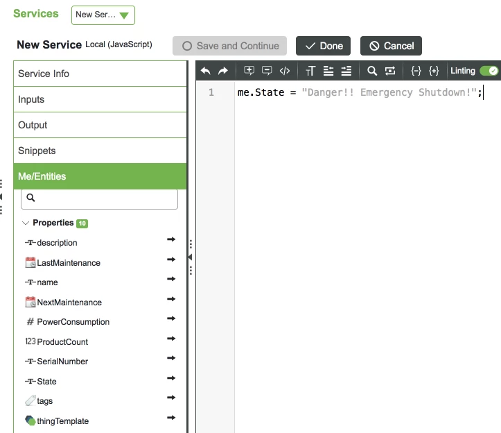

6.  Switch to the Services tab.
7.  Click Add.
8.  Enter EmergencyShutdown as the name of the service.
9. Switch to the Me/Entities tab.
10. Expand Properties.
11. Click the arrow next to the State property.
12. Modify the generated code to match the following:
me.State = "Danger!! Emergency Shutdown";
Your first Service is complete!
13. Click Done.
14. Click Save to save your changes.
Your Service should match the below configurations.

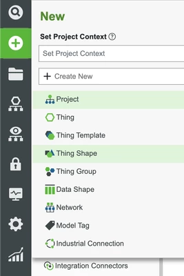

  2. Select Thing Shape in the dropdown.

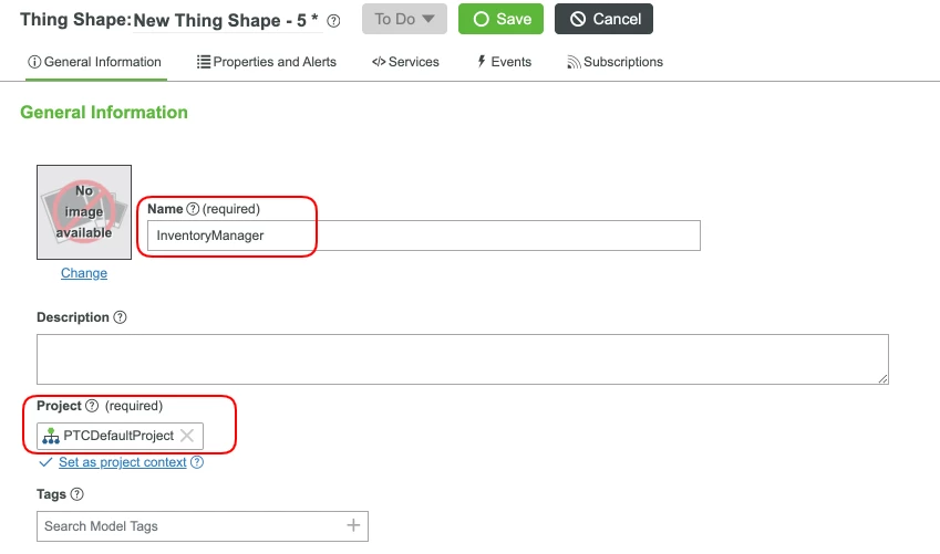

  3. In the name field, enter InventoryManager and select a Project (ie, PTCDefaultProject).

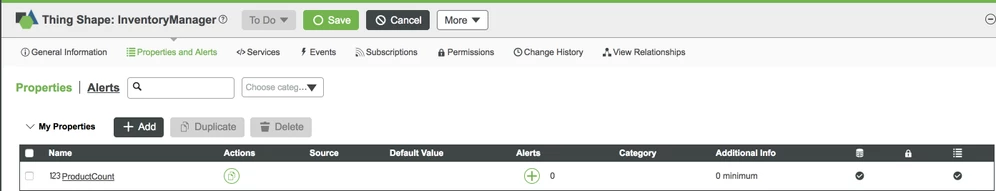

      4. Click Save then Edit to store all changes now.IoTProductMgmt_15-1659126751204.png

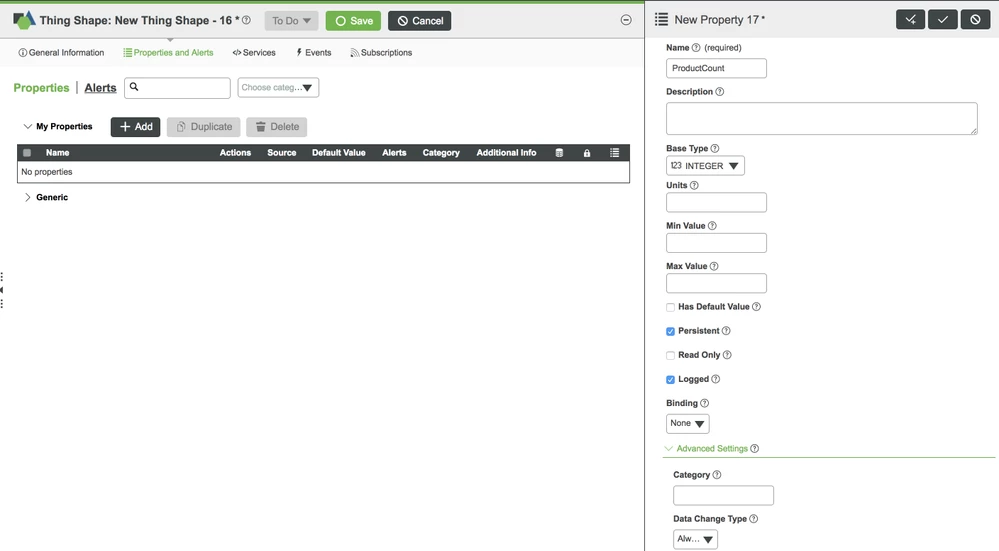

      5. Switch to the Properties tab.
      6. Click Add.
      7. Enter ProductCount as the name of the property.
      8. Select the Base Type of the proprty from the dropdown (ie, INTEGER).
      9. Check the checkboxes for the property Aspects.
     10. Select the Data Change Type from the dropdown.
     11. Click Done when finished creating the property.

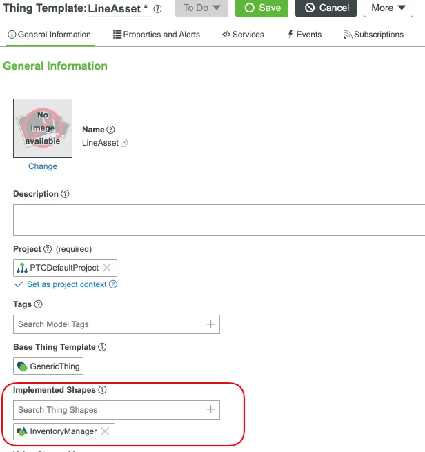

We can see that there is some overlap in the components of our HazardousAsset and LineAsset ThingTemplates. In particular, both want information about the product count. Because HazardousAsset inherits from LineAsset, would only need to change LineAsset. Follow the steps below to perform this change:
  1. Open the LineAsset Thing Template.
  2. In the Implemented Shapes field, enter and select InventoryManager.
  3. Save changes.
