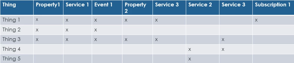

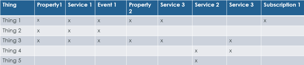

Sample Thing-Component Matrix
As a generic example, look at the chart presented here.
You have a series of Things down the rows, while there are a series of Components (i.e. Properties, Services, Events, and Subscriptions) in the columns. This allows you to logically visually identify how some of those Components are common across multiple Things (which is very important in determining our recommendations for when to use Thing Templates vs. Thing Shapes vs. directly-instantiated Things). If we were to apply this idea to our Smart Factory example, we would create two sections of our Thing-Component Matrix, i.e. the Overlapping versus Unique Components.
NOTE: It is not necessary to divide your Thing Component Matrix between Overlapping vs Unique if you don't wish to do so. It is done here largely for the sake of readability.

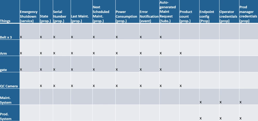

Overlapping Matrix
This matrix represents all the overlapping Components that are shared by multiple types of Things in our system:

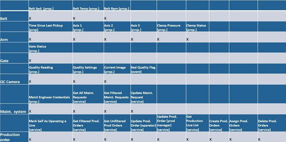

Unique Matrix
This matrix represents the Components unique to each type of Thing:

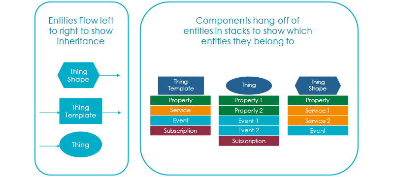

Entity Relationship Diagram
To standardize the represention of Data Models, it is important to have a unified view of what a representation might look like. For this example, we have developed an Entity Relationship Diagram schematic used for Data Model representation. We will use this representation to examine how to build a Data Model.
