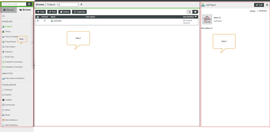

Three areas layout
Figure 4
  •   Menu bar on the left (Area 1)
    • Set Project Context to set default project name for new entities
    • Two views: Recent and Browse
      • Recent view will quickly locate the recent access entities
      • Browse is almost the same to the old menu navigation bar

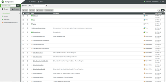

    • Could be sizable or hidden, and the main idea here is to increase screen real-estate to allow bigger view/edit area
  • Main area for listing and feeding entities in the middle (Area 2)
    • It provides you a wider area to edit entities (author services, mashup builder, etc.)
  • An extra area on the right for preview, properties/events editing, etc. (Area 3)
    • It gave you an easier and handy way to get a glance of an entity’s basic information

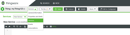

  • When you create a new Thing, you will find all the facets (general information, properties, services, events, subscriptions) of the Thing are listed in a dropdown list
Figure 5
By doing so it will save more area for the feeding

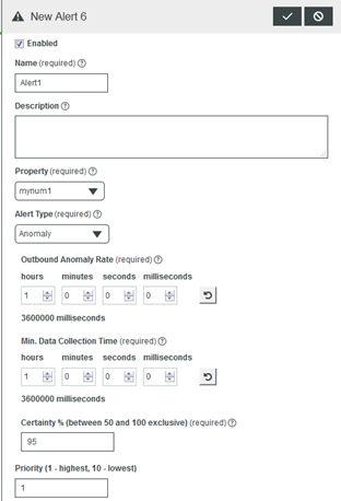

  • From ThingWorx 8.0.0, Anomaly Alert type is supported
    • An anomaly alert is only useful if you have configured Anomaly Detection to monitor a stream of data
    • Anomaly metrics settings are allowed to be configured in the Alert edit page
Figure 9
