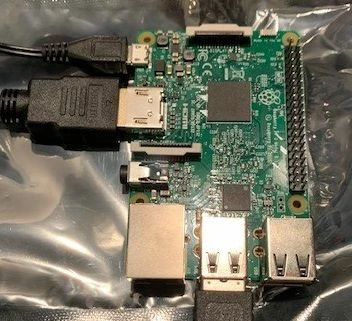

A Raspberry Pi is a small, single-board computer that utilizes an ARM processor and typically runs a variant of Linux.
Due to its small size, relatively affordable cost, and ability to run a full operating system, the Pi is a near-ideal device to utilize as a Proof-of-Concept (PoC) IoT Edge device.
In addition, there is a version of the ThingWorx Edge MicroServer (EMS) built to work on ARM processors. Therefore, this guide will explore getting the EMS running on a Raspberry Pi to connect to ThingWorx Foundation.

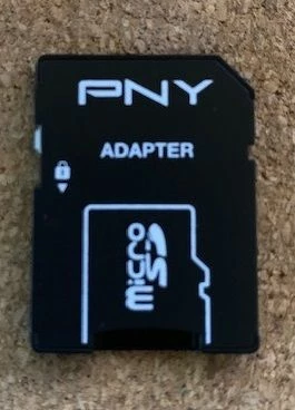

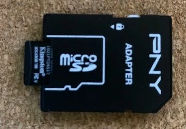

Depending on your PC's ports, you may also require a microSDHC adapter to insert the flash card into your computer.

  2. Locate your flash card adapter.
    • Note that you may have a different type of adapter. Simply ensure that your PC can recognize the microSDHC card.

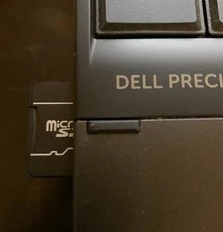

  3. Insert the microSDHC card into the adapter.
  4. Insert the adapter-plus-microsdhc card into your PC.

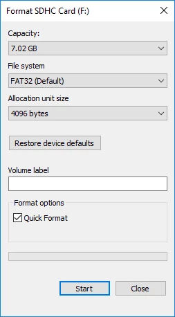

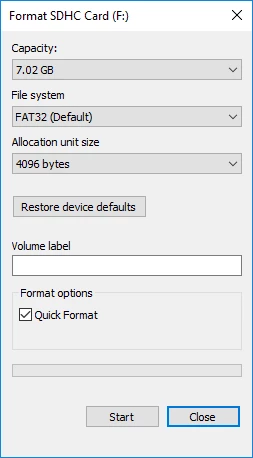

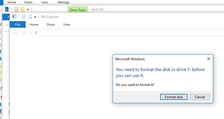

  5. Assuming a Windows PC and either a pre-installed or corrupted flash card, you will receive a pop-up stating that it needs to be formatted prior to use; click Format disk.
  6. On the following Format SDHC Card pop-up, click Start.

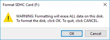

  7. On the following Format Confirmation pop-up, click OK.

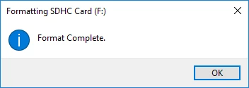

  8. On the following Format Complete pop-up, click OK.
  9. On the previous Format pop-up which is still open, click Close.

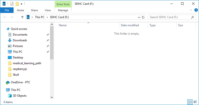

  10. You now have a formatted microSDHC card which Windows can recognize.

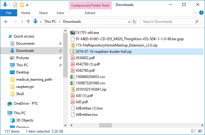

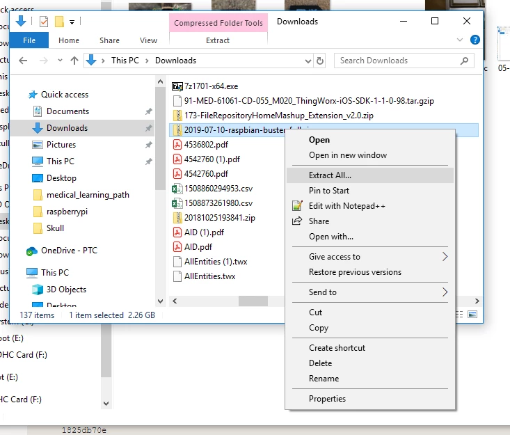

  1. Download the Raspbian OS .zip file.
  2. Navigate to the download location and locate the Raspbian .zip file.

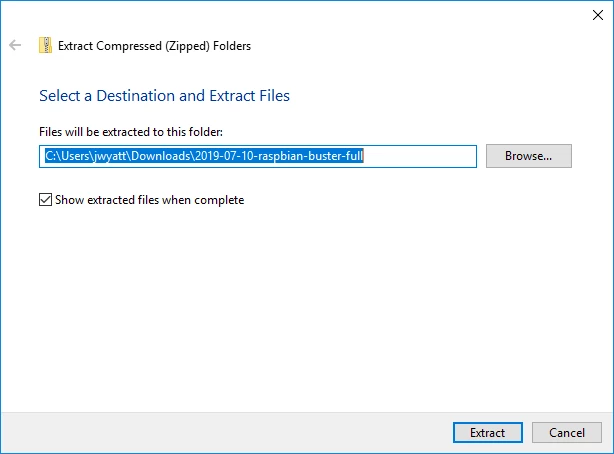

3. Right-click on the file and select Extract All....
4. On the Extract Pop-up, click Extract.

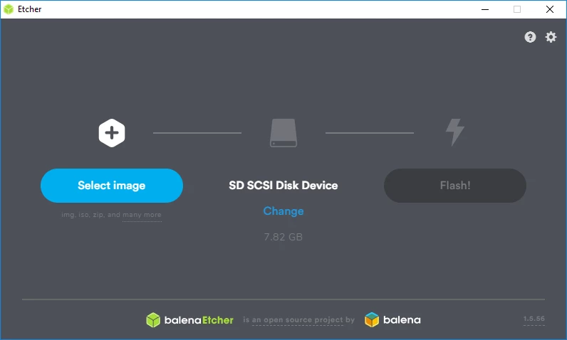

5. Download the balenaEtcher "flasher" software.
6. Navigate to the download location and locate the balenaEtcher .exe file.

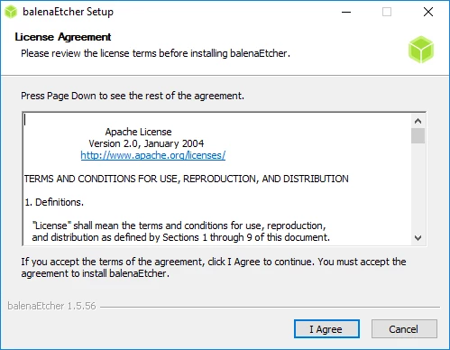

7. Double-click on the balenaEtcher .exe to begin the installation process.
8. On the balenaEtcher installer pop-up, click I Agree.
  • After the installation completes, balenaEtcher will automatically open.

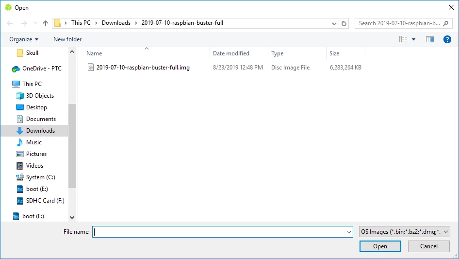

9. Click Select image and navigate to the previously-extracted Raspbian OS .img file.
10. Select the .img file and click Open.

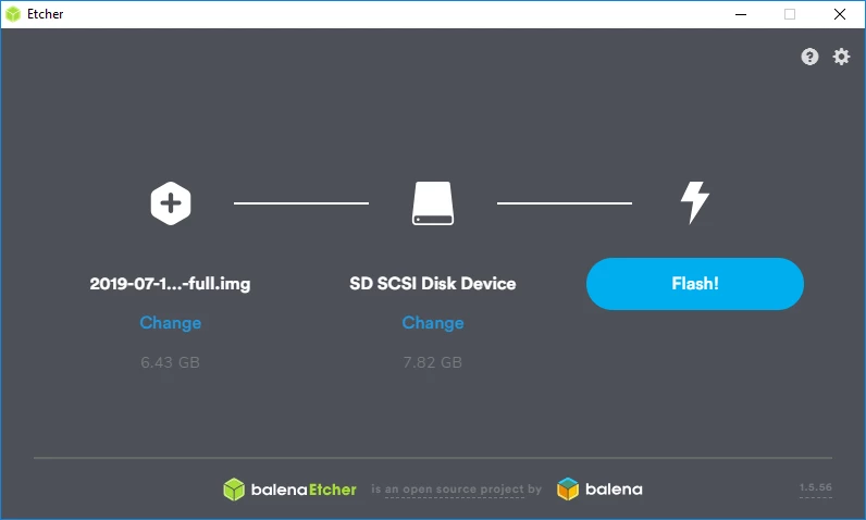

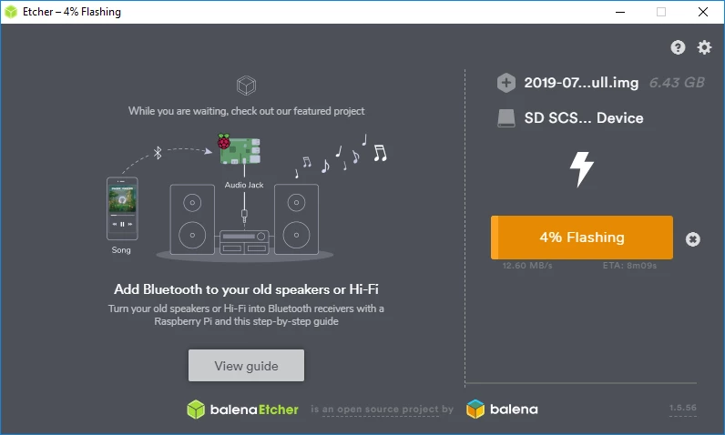

  • Assuming the only microSDHC card currently inserted into your PC is the one for the Pi, then the SD SCSI Disk Device will be pre-selected; otherwise, choose the correct flash disk.
11. Click Flash!.
  • Accept allowing the etcher to make changes to your computer.

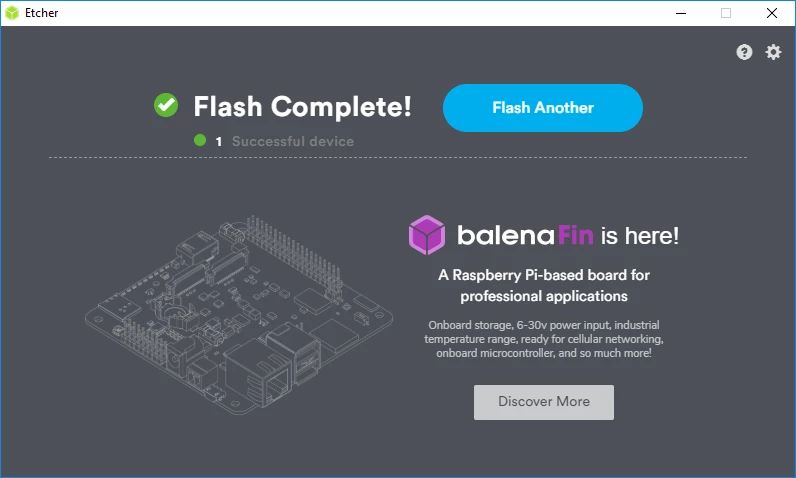

12. Wait for balenaEtcher to complete the flashing process; this may take ~5-10 minutes.
13. Remove the microSDHC card and adapter from your PC.
