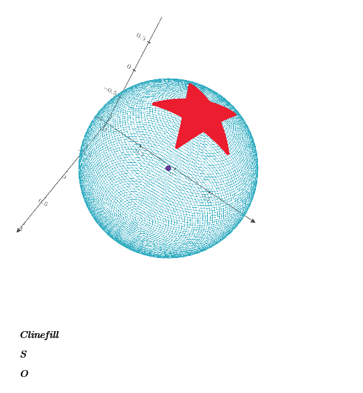

Here is a 3D model in Creo 9 of the sphere and points:

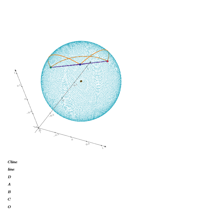

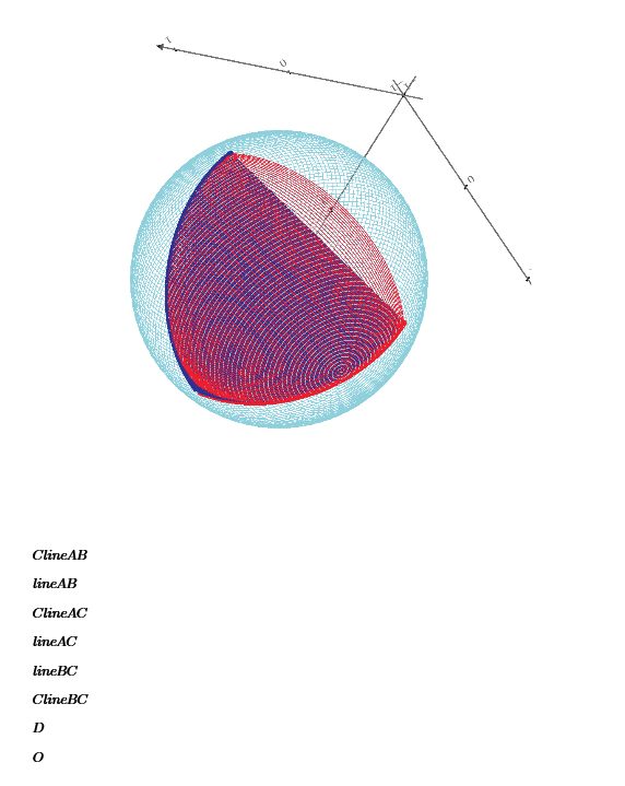

Thought I would get the ball rolling.

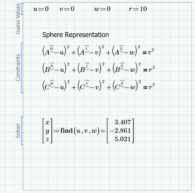

The coordinates supplied for three points on the sphere are correct the origin of the sphere is not at 0,0,0.
Enclosed is my solution and 3D model checking of the procedure to calculate the area.
Fulfilled the first option with a program that solves for area given three points on the sphere and a radius.
Used the program in some test cases.
Cheers
Terry

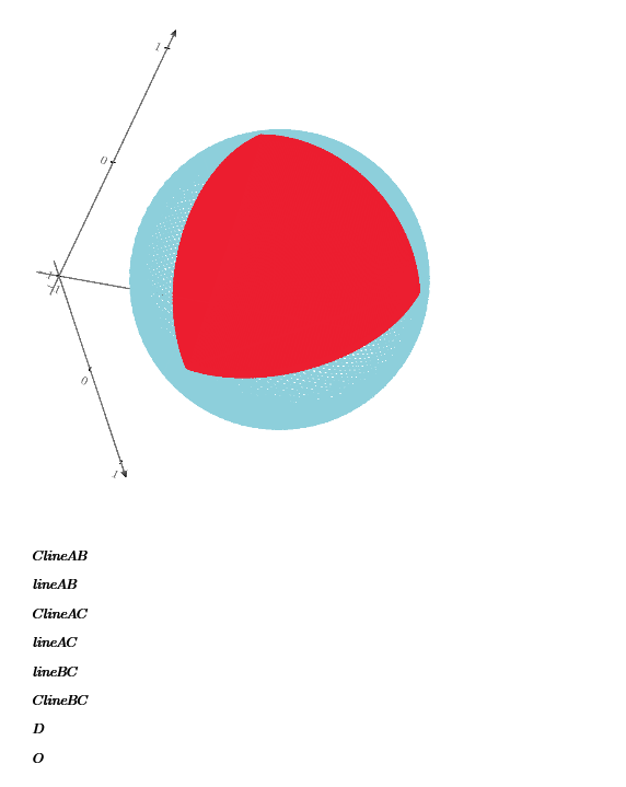

July 5, 2022
Spotted a couple of things so would like to repost solution.
Cheers
Terry
July 5, 2022

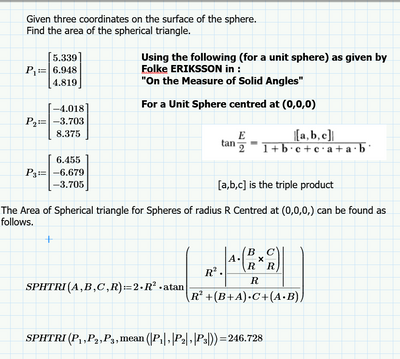

The second optional part of the challenge was to get the spherical triangular area in terms of a,b,c,d,e,f,g,h,k being the nine xyz coordinates of the three definition points.
Here it is using an alternative to Girard's Theorem called L'Huilier's Theorem that is easier to apply.
It is a long definition so needs to be seen in draft mode.
Cheers
Terry

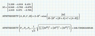

July 5, 2022
Having the sphere at the origin simplifies solution.
Solved by Girard's and L'Hilier's theorems.
Cheers
Terry

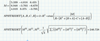

18-Opal
July 5, 2022
As pointed out by Terry - still works with the original data but the center is as follows:
18-Opal
July 12, 2022
The equation cleaned up a bit.

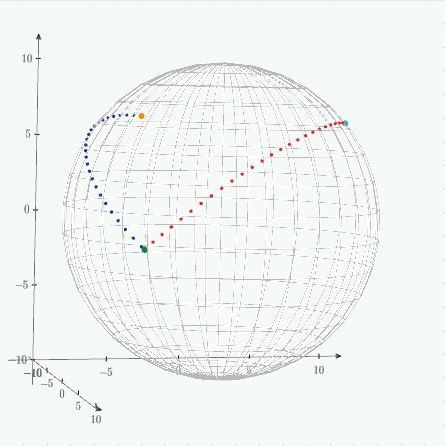

August 8, 2022
Some of the elements building up to calculation of the area can be useful too. Here is a version that shows those details.
