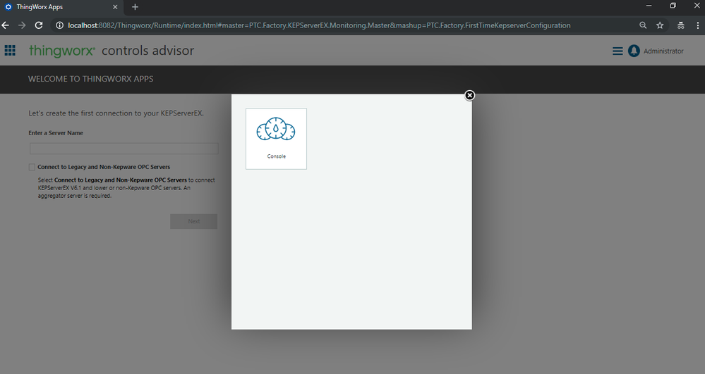

I am facing problem in Manufacturing Apps. I imported all extension in thingworx 8.2 version and after accessing app it show me only console window option not other. i am not getting any kind of error/ exception while importing extension .

But still its is not show other option... first time its open configuration module and the after clicked on menu option only console module option is visible.
anythings else I need to do ?
