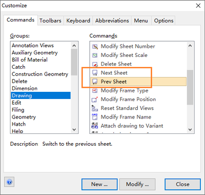

Hi~
I want to know how to set active other sheet.  Anybody know it?
bjyuen
(To:bjyuen)
I found the commands.

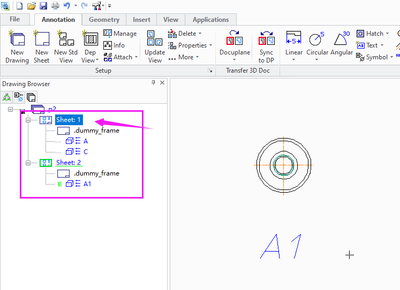

SmallCrucianCar
(To:bjyuen)
The green icon to the left of the sheet name indicate the active sheet. To set the active sheet, click its icon.

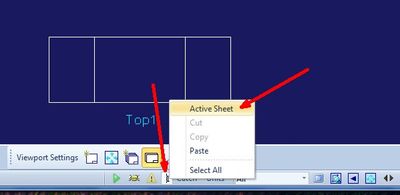

FriedhelmK
(To:bjyuen)
Right klick this field. Then klick Active Sheet
Annotation shows all existing sheets in an overview.
Klick on one element of the sheet that you want.
Success 😉
