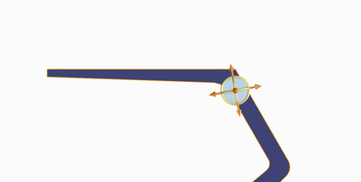

Im using Creo Elements Direct, when i press this part the cursor is not straight.
Can i change this?
I think it is good to create a NEW WP + Construction Geiometry in the direction you want in advance and switch the direction of the 3D CoPilot after executing the command.
How?
After creating the part it was turned around in the room.
Perhaps it was startet inside an assembly, but when loaded alone, the cursor follows geometrie.
