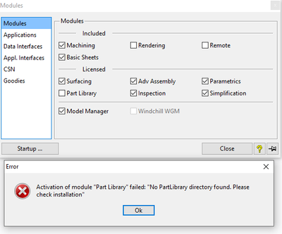

Hi Kotom,
Thanks. I did find out through a colleague that we chose to not get this module due to cost.

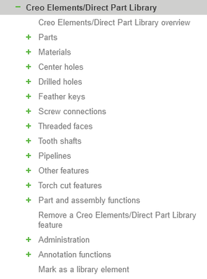

However when I looked through the PTC website it looked like it's an extention that is included in the base program?
But I didn't manage to activate it on my workstation.
The error was:
Activation of module "Part Library" failed: "No PartLibrary directory found. Please check installation"
And not something like:
No licence for part library found
So is this extention included in the creo licence, and is it just a matter of setting it up? Or is it a seperate licence?
We seem to have all modules available besides the Part Library. Which seems weird to me.
Indeed Part Library is not free (it's a nonsense since standardisation is the heart of engineering).
Therefore, you need a license.
You need to install the Part Library software as well.
