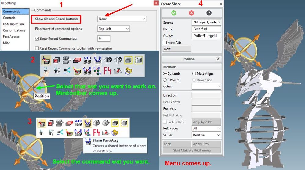

Hi Dan
I've been doing this for some time now:
File - Settings - UI ... - and set "Show OK and Cancel buttons:" to None
This tip came "then" from PeterKehoe

DanAdler
(To:FriedhelmK)
Thanks for your reply @FriedhelmK
Unfortunately this does not work for me in v20.2.1. I changed to display None however the little green triangle still comes up with every command and I have to click on it to display the full dialog.

Hi Dan,
just installed 20.2.1.0.
For me, the automatic opening of the individual menus when selecting the various commands works as usual.
Sometimes it takes a while for them to open.
I added some screenshots to show how I do it.
First click on the command in the mini toolbar.
If you pull directly on the Polstar then the 1st command Top Left is selected and the menu does not come but the green triangle.
