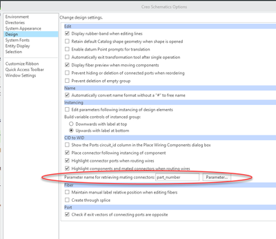

I've been using Schematic for about 3 months now....slowly getting acclimated.
I want to learn how to use the circuit diagram feature of Schematic, but the overall support for this very lacking.
Does anyone have a guide that they have used for this?
Some of the things that I would like to learn:
  • How to create circuit diagram components with Wiring diagram connectors (mating connectors to the CID components)
  • How to create a WID from the CID
Thank you

you can find info about CID/WID in the help  center topic About Creating a CID to WID Design .
in CID/WID design you need to set the following :
  • mates_with parameter - this parameter hold the value to look for in order to find the the mate connector in the catalog
  • in options dialog , Design tab -> you need to set the parameter name which hold above value (in which parameter Creo Schematics will look for the above value) , i.e. :
    in this example , Creo Schematics will look for mate connector which have the value defined in mates_with (in the component) in parameter part_number (in the connector)
  • num_of pins - if defined in connector Dataset - connector will b created with proper number of pins (members/ports)
Creating WID from CID :
 read topic  About Placing Component Wiring Shapes and the topics following it .
