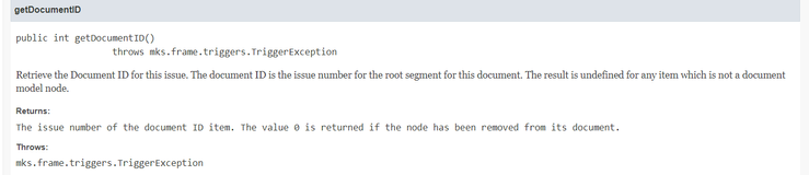

Hello team,
How to get correct DocumentID right after Requirement creation in a trigger?
very simple code returns 0
theRequirementDocumentID = delta.getDocumentID();
print("*** Requirement Document ID for " + delta.getType() + " " + delta.getID() + " is: " + delta.getDocumentID());
After second Text edit it goes ok though.
But I need to get DocID right after Requirement creation.
Problem in trigger Rule definition?
Now set as Type = New [Requirement]
Many thanks,

Hi @AN_10548594,
"Document ID" field is being calculated after creation of an item.
Try to execute your logic in a "Post" trigger which will run after your new requirement is saved to DB.

There is possibility to modify item in post trigger by using CLI commands instead of trigger API.
It's not very sophisticated and recommended and you need to be careful with that but sometimes there is no other way to achieve the goal.
Here is an example of command execution in script, you can find more options in the documentation.
var apiSession = environmentBean.createAPISessionBean();
var runner = apiSession.createAPICommandRunnerBean();
runner.setCommand("im", "<command>");
runner.execute();
Using "Document ID" field with versioning is quite risky as it could be not available for versioned item (usually it's there only for live items).

Hi again,
And this is what TS says about this:
"The document ID is stored in a field named Document ID. When a new item is created, the value of the Document ID field hasn't been commited yet during the PRE trigger phase.
To get the document ID of a newly created item in a PRE Trigger, use the getNewFieldValue("Document ID") method on the ScriptIssueDeltaBean."
Regards
And this is wrong answer from TS
