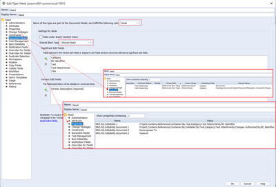

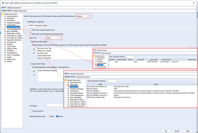

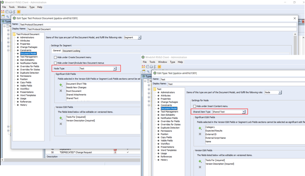

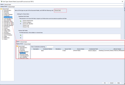

Hi Kartik,
Thank you for your response. Yes, I did update the document model with the new types. Please refer below the screenshots with the details.
Thanks and Regards
Sukanya Mahto
