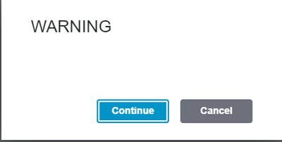

I need to add background color to the buttons on the confirmation box.

Please try below custom CSS code to see if it works.
ptcs-confirmation-dialog::part(primary-button) {
    background-color: red;
ptcs-confirmation-dialog::part(cancel-button) {
    background-color: grey;
You can also add :hover, :focus at the end of the selector to change the background color of the buttons at different states
