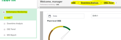

I would like to have a breadcrumb functionality that shows me the hierarchy of the mashup that I am currently on. e.g., Main menu item/sub menu item/sub-sub menu item.
What I want to achieve is similar to what is highlighted in yellow on the first screenshot below:

Hi community,
I managed to get a hierarchy of the mashup that I am currently on. e.g., Main menu item/sub menu item/sub-sub menu item.
I did this through a service.
This service would take the current menuId, find its parentMenuId, and then continue to find each subsequent parent until the top menu item (with a parentMenuId of 'topMenu') is reached.
Now that I have achieved this, I would like to be able to view a drop-down list of available menu items when I hover/click on the initial items in the breadcrumb. This dropdown should contain a list resembling that of a sub-menu when its main menu item is clicked provided that this menu is a three-level menu.
Has anyone been able to accomplish this before using thingworx?
