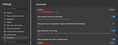

If you want users to download to local PC and specify target folder, users need to change the settings in browser as mentioned by Velkumar
Tony
8 REPLIES 8
Velkumar
(To:AP_10343008)
Hi @AP_10343008
You can change download folder option in browser
I don't think you can control it in widget level.
/VR
AP_10343008
(To:Velkumar)
That is common for every operation.
I want to store file in repository when user clicked thingworx button widget, Apart from this activity, user can decide folder location for other browser related downloads. I want both to be two different locations independently.
