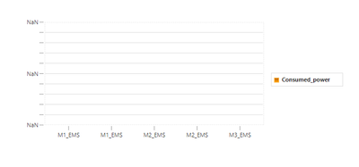

I am getting data now but unable to see in Chart, its showing value as 'NaN' at Y-axis. i have attached snap please check it. and i am able to see all data/fields as result of service. why its showing NaN?
Thank you
Hello @VaibhavShinde,
You need to select correct DataFieldX properties as well.

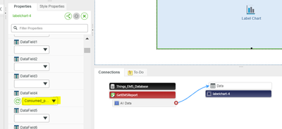

Hi @Constantine ,
Please check below snap what i am doing..

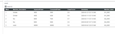

This is infotable i am getting after running individual service which i am binding to Label Chart.
Consumed_power field is at no.4 in infotable same i selected in properties of chart.
This is DatafieldX  as per infotable..

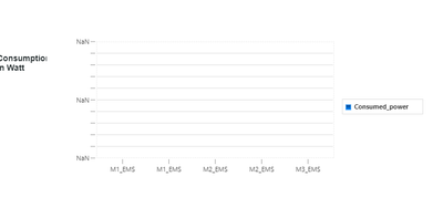

 and the result--
Can you also show the Data Shape definition for this infotable?
Vilia (my company) | GitHub | LinkedIn
this is the Datashape..
Looks like you renamed your data shape fields! You have "ConsumedPower" on one screenshot and "Consumed_power" on the others. Make sure they are all aligned and it will work.
