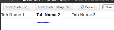

I have a mashup with two tabs. Despite setting the selected tab via an expression the other tab will not be selected, it seems like only the default tab can be selected via that event.
When using the tab widget, despite setting the selectedTabValue to a number corresponding to the tab, the selected tab does not change, could someone provide an example of how to programatically change tab (with the correct bindings)?

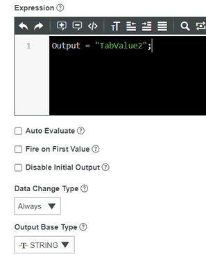

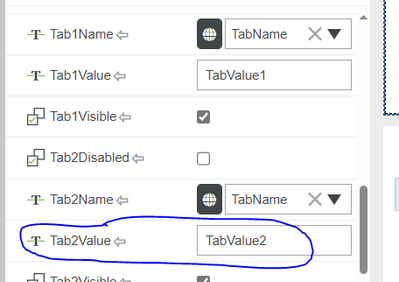

SelectedTabValue should be Tab Value not corresponding Tab Number.
You should pass TabValue from your expression
