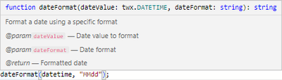

Seems to me like you are missing an argument for the dateFormat function. The dateFormat function takes two arguments, dateValue and dateFormat:
See below example:
let datetime = parseDate("2023-03-07 15:09:57.00", "yyyy-MM-dd HH:mm:ss");
result = dateFormat(datetime, "MMdd");
This will result in a string that contains: 0307
And I think that is what you are trying to do so I hope this helps.
