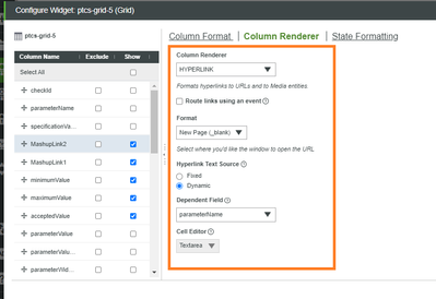

I have a ThingWorx grid with two IP address columns (IP1 & IP2). Clicking on the IP column in the grid should redirect me to a webpage with the IP address as a URL. Is this feature available in grid? Sharing a code snipper is more appreciable. Thank you.
Hi @SKannapiran ,
Yes, We can achieve in the grid, Please try with below suggestions:
  • Create 2 Hyperlink Basetype columns in output of your datashape & add the URL Link based on each IP Columns for each row on your requirement in the service itself
  • In Mashup Grid > Navigate to Configure Grids > (HyperLink1) Column Render and update the Link Format as New/Replace and HyperLink Text Source as Dynamic based Dependent Field(String) you can choose your IP1/IP2 which needs to display in UI grid
  • Repeat the above step for the 2nd HyperLink2 column.

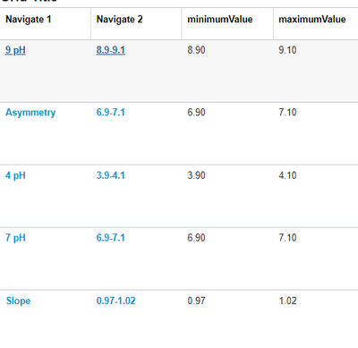

& In Front end output

Hi Arun,
After implementing your solution, on clicking the HyperLink column, it is taking us to a new web browser with the URL
http://<<thingworx URL>>/IP address. But we need the URL to be framed like http://IP Address.
Hi @SKannapiran ,
Have you verified the URL which you have formed in your service infotable, because based on that URL link it will directly navigate to that window.
Sample Code:
Till you have any queries means please explain us more and if possible share your code here for better understanding.
