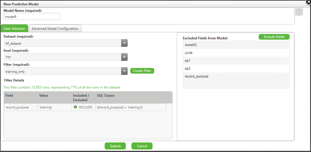

Step 3, create Machine Learning model.
Click Analytics Builder >> Models >> New.
Select dataset, and select goal field and filter, and select excluded fields:

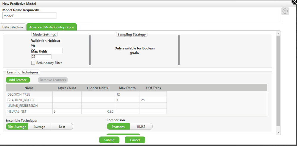

Click Advanced Model Configuration:
In Machine Learning, normally we split data into training set, validation set, and test set, with rate of 60%, 20%, 20%.
In this step, we can use Filter to filter out test data, and use Validation Holdout % to define percentage of validation, we can use default setting of 20%.
Learning Techniques includes possible Machine Learning algorithms, we can manually add algorithms and modify parameters.
For each new model, I’d suggest to training it with different algorithms, and test them to get the most accurate one.
For same algorithm, we can train it with different parameters.
Ensemble Technique is the mix method of multiple algorithms, we can try and test with different settings.

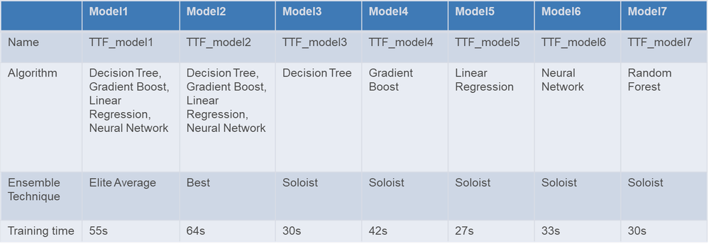

My training methods:

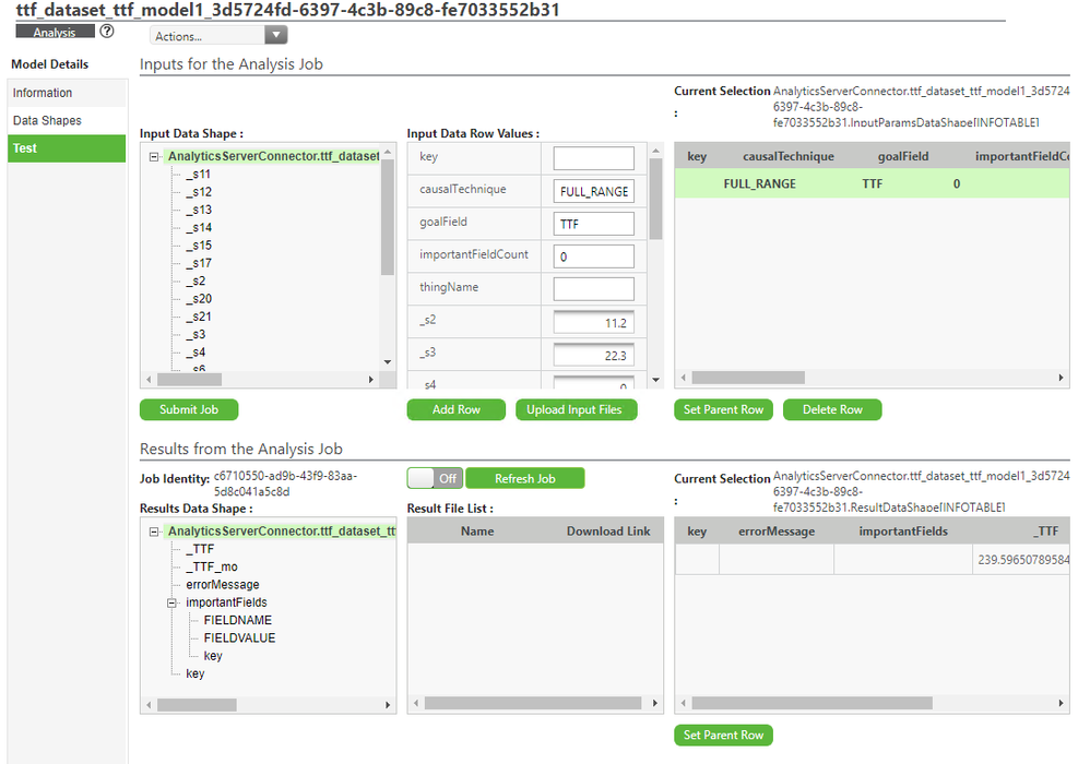

Step 4, test model.
The test page will pop up when model is published, and we can also access it by: Click Analytics Manager >> Analysis Models, select model, click View >> Test:
For causalTechnique, normally we set it as FULL_RANGE.
For goalField, input name of goal field.
Then input values of all features/sensors, and click Add Row. In case of time series data, we need to add multiple rows for it.
Select 1st row, click Set Parent Row, then click Submit Job.
System will calculate and get result based on model and input values.
It might take a few seconds for calculation.
Under below Results Data Shape, select AnalyticsServerConnector.xxx, click Refresh Job, then you can see the result value.
For more detail information, you can check from Analysis Jobs.

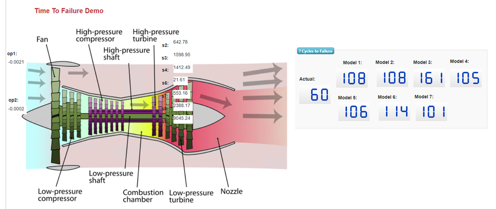

My TTF Demo Mashup for reference:

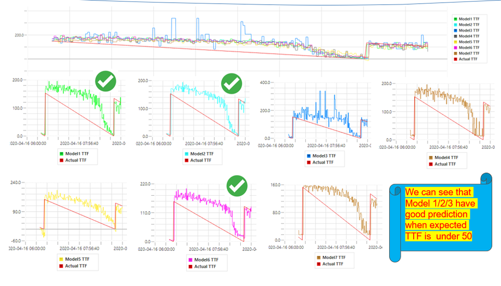

Comparison of different models:
