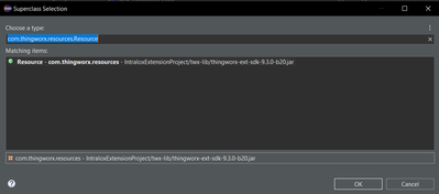

What happens when you click "Browse" right of the Superclass field?

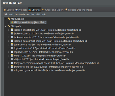

Looks like it can't find the com.thingworx.resources.Resource in its classpath. Make sure the project has thingworx-ext-sdk-9.4.0-b49.jar (or your version) in the build path. (Project>build path>configure>java  build path> libraries>Classpath) Make also sure this is the only jar in your build path containing com.thingworx.resources.Resource so you don't have a collision.
Hi @Rocko,
Sorry for the delay. When I click browse there is only one com.thingworx.resources.Resouce. I have tried with various versions of the thingworx sdk with no luck.
these are the current jars

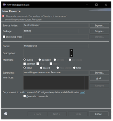

The issue is when creating a Thingworx Resource Entity using the Thingworx Eclipse Plug-in.
I have created a Thingworx project with the plug-in, chosen Ant build and have included the TWX SDK.
Then when using the Thingworx Source from the Eclipse plug-in to create the Thingworx entity Resource. The plug-in wizard displays an error preventing the Resource type entity from being created:

To me, your build path looks fine.
When you click Browse, the needed class appears in the list, so it is available.

I am unsuccessful using the latest versions of TWX SDK, TWX Eclipse Plug-in, and Eclipse IDE. The only way I have been able to successfully create a TWX Resource Entity is by using the following combination:
  • Eclipse 2019-12 (4.14.0)
  • JAVA - jdk-11.0.16
  • Thingworx 9.1 SDK (PTC Software download page does not provide a version lower before  9.3.0 so need to open a PTC to request this version)
