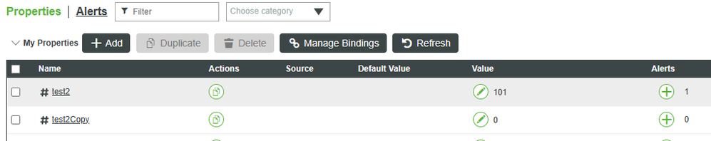

Hello,everyone!
Why does the log report an error when using alert as a subscription input?
This is the property I entered:

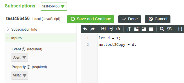

Here's the subscription I wrote:

Hi @Snoopy_hu ,
Have you enabled the subscribtion in basic information and  can you please add debug logger to find whether the alert subscribtion isrunning at time of main alert.

Hi.@Arun_C
Yes, I've started the subscription and added the error alerts at the same time, but the error alerts really don't take effect when the subscription is triggered.

Hi @Snoopy_hu ,
If possible can you please the test entity here, I will try to figure it out.
