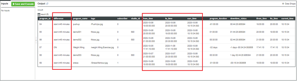

I want to calculate the downtime status which shows in below image,
I am creating a program that has 'from_date and 'to_date' and their program so I want to display time status which is shown in the below image.
use case.

I have created a thingworx service that calculates the downtime status but I am not getting actual time difference between date-time. please check the below code please correct me where I was wrong

here is my output please check the program from_time and to_time and system current time.
The problem I am facing is a difference of two times(according to program) is not correctly shown in the difference column.
Example.
program id 54 will start on 2020-10-06 19:00:00.000 and the current time is 2020-10-06 18:37:10.382,
It means the program will start in 27minutes but the result in the different column showing 45 minutes.
I hope you get my point.please suggest me right way
