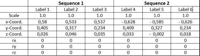

The following requirement:
  1. When the sequence 1 is played the labels 1, 2 and 3 have to be visible.
  2. When the sequence 2 is played the labels 4, 5 and 6 have to be visible.
  3. In all of these labels are only one word in it, so not a step description or something like this.
  4. Here is a sample table with coordinates for a better overview:
There is no a real reason to have 4,5,6 here. In this case we can use 1,2,3 again - also for step 2 but we could here change the position and will change the text content. In this case we need to have to define number of 3DLabel widgets which is equal to the maximum of used notes per step - and display and update only the necessary number of widget in particular step.

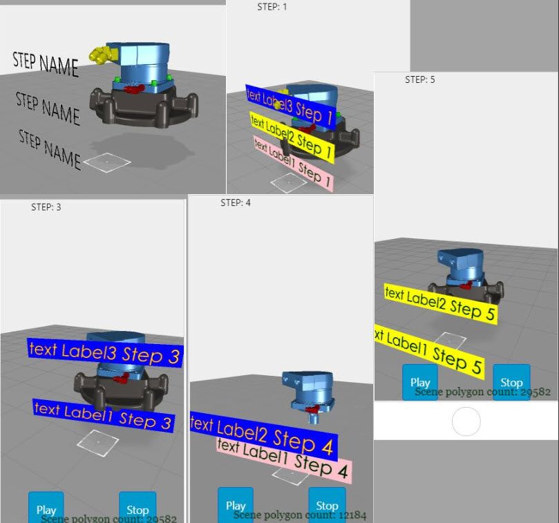

To demonstrate the workaround the following example was created and tested. This   example should show the suggestion above. It is not perfect but should demonstrate the general approach to achieve similar goal.

  • Finally,  the project was  tested  and  it was working as expected:
The demo project is attached to this article.
