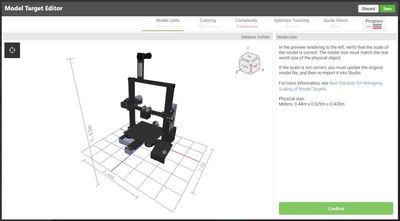

As part of the Vuforia Studio 9.13.0 release, a new way to create and configure model targets is now available!
The updated Model Target widget allows users more configuration options within Vuforia Studio to ensure optimal tracking of their models. Advanced configuration options include:
  • Automatic coloring of Model Targets
  • Simplification when model is too complex (Advanced Views only)
  • Multiple Advanced Guide Views
For additional information on these new options, see our Configure a Model Target Help Center topic.
