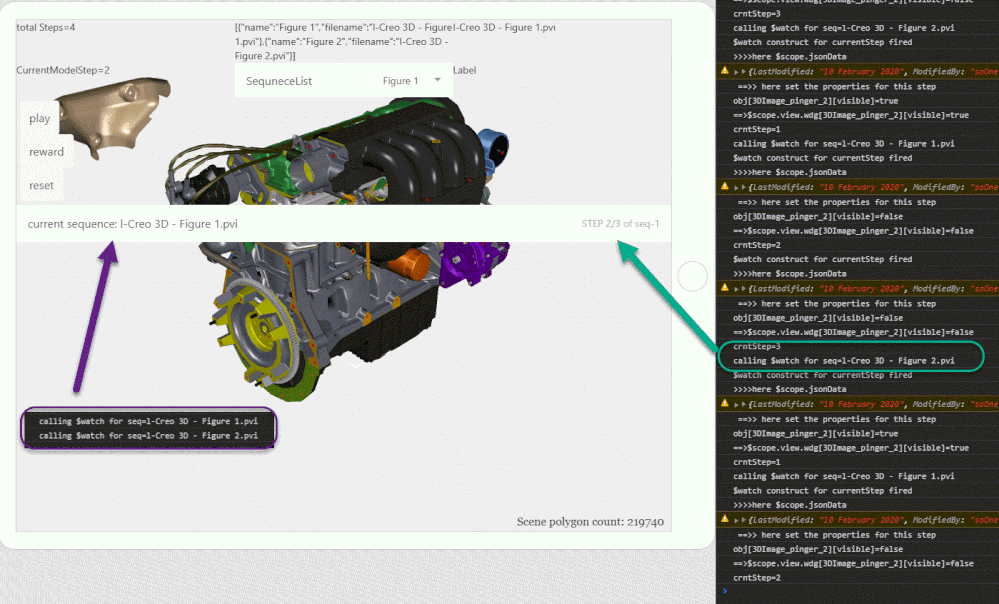

I do not think that the code will work as it is in the post.
Why not:
- you will track in the $watch the change of the sequence – right? But this will only occur when you change in the select the sequence. This will not call a play and will not change the step number. When you play later the model this will not call the $watch construct – so that the current step will here never update – because it is not inside the $watch construct.
If you place it inside the $watch then it will get always one because when you change the sequence it will be always 1. When you play the sequence step 1..2….3 it will not update.
I modified it to 2 different $watch for the currentStep and for the sequence and I think this will work.

The basic principle is that when you change a sequnece then you have to set step number 1.
And when you play - change the step then it is alway the 'old' already known sequence....

Hi @dsgnrClarK ,
so far my understanding here , the real problem is not the embedding of switch inside switch statement /block. This is working fine. If you check my code I used also the 2 embedded switch blocks for each events
The problem here is the event – when it fire which values already initialized. In your original code you observed the change of the sequence value. When you set the sequence, it will set the step to 1. So this should work, but maybe, we will have an synchronous problem that the step is not already set when the function of the $watch control block is called . Of course, you can try call it with timeout delay but I do not recommend this.
What is better, when you set the sequence you can use the first step because it will be set by default. Therefore, my recommendation is to check in second $watch control block the step change – as event where you have also 2 embedded switch control blocks for the sequence and step number. Because the value for sequence and step now exist / are defined/ at the time when the event is fired, therefore this will work fine. At least this was my observation when I tested the issue with the attached code.
