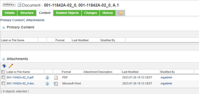

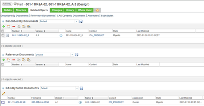

There is two things. Looks like the migrator is loading the document and linking it to the WTPart. If the document does not exist, it cannot create the link. Check for the existence of those documents keying off third column (001-11842A-01 for example). It looks like both of those files are loaded to the same document. Remember, we are storing documents, not files. Many files can exist in one document. Strange, there is not an indicated which file is primary and which is secondary.
wait, you are saying that the third column is the WTPart number? Or did you enable content on WTParts? Am I correct in assuming both of those files resolve to the same document?

for this part the situation is correct but i have several situation where the documents are not loaded
Looks like your loader is chopping off the file extension and using that for the number and name. That's not going to be very helpful for your users. Numbers should follow your company pattern and names should be a descriptive name, document title, etc. You will have to do some clean up later to fix these.
Second, it looks like it loaded the files all into secondary content (attachments). This is not a folder, do not get confused by that. These are objects and a document object can have many files associated to it. One is declared primary and when users look for these documents, the primary is presented first (like i in a search results or where ever document appears). Users can download and view that directly. Nothing was declared primary.  I would assume that you would want the PDF file as primary. I would strongly suggest fixing your loaded program as effort to correct this later is about same as if you loaded all of these manually.
To the original question, you would be searching for documents with numbers like "001-11842A-01_0" in your example above. However, is that truly the document number in your org? Remember, Documents do not equal files. Many files can be part of the same document.
