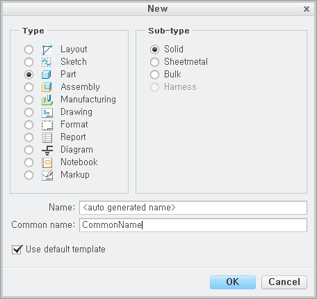

Hello, everyone
Can I use parameters for naming and numbering?
We are going to establish a naming and numbering scheme for businesses that are introducing PDM.
We are going to propose the following.
#### _ #### _ <button> .prt or #### _ #### _ <button> .asm
#### means a four-digit number.
The first four digits represent the part number, and the middle four digits represent the pid.
The last <name> will be the name of a generic model.
The 4-digit number will specify the number following the OIR in ORACLE DB.
The last <name> will be the name of the file you will enter.
In combination, EPM documents will be given a number and file name.
The public name will have only <name>.
Each type also expects parameters like parameters PTC_WC_PART_NO, PTC_WC_PRODUCT_ID, and PTC_WC_PART_NAME.
Can I use WINDCHILL PDMLink systematically to satisfy the above requirement without having to use CREATE RELATIONSHIP in CREO?
If possible, please let me know about the approach.
Thank you.
Kind Regards

In addition, I will explain again.
I hope the results are as follows.
In PDMLink, the numbers are specified as follows:
The same is true of names.
"00007_ <CREO_PARAM_VALUE> _CommonName"
we want the file should be the format like "Common Name . Type"
So how do i write code in OIR?
