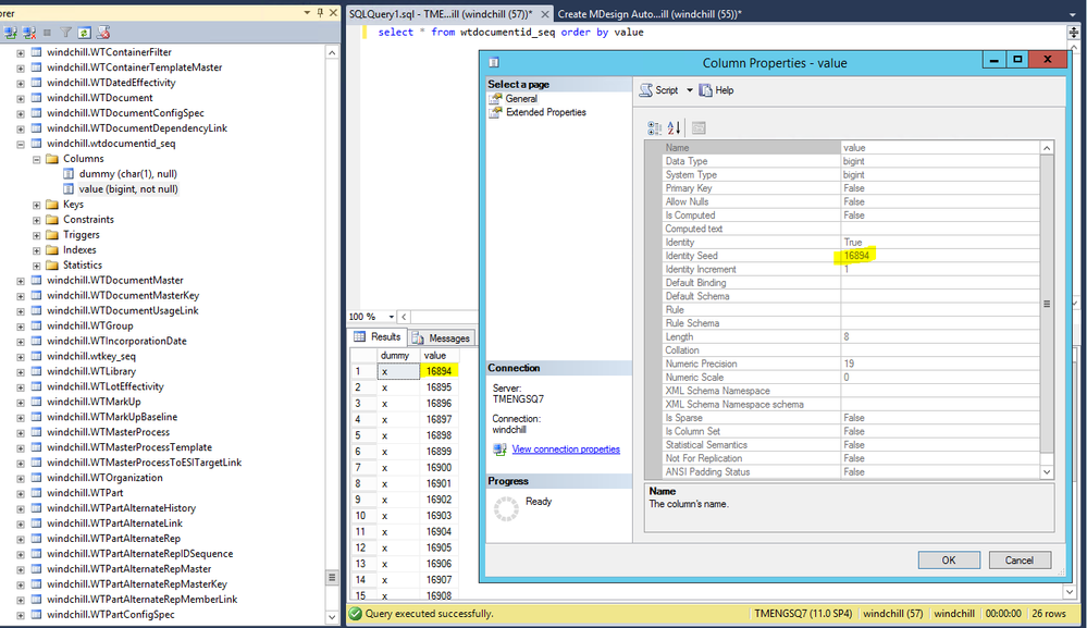

We have several legacy files that follow a numbering scheme but are not necessarily in order. I want to change the next document number value instead (ex instead of 00010, I want it to be 00100). All the documentation points at how to CREATE a sequence, but not change it. Does anyone know how to set the value for the sequence after the table as been created?

Each sequence has it's own table:
Each table has a column with a seed value.  This is the starting sequence number.
Changing the next number requires changing this seed value:
DBCC CHECKIDENT('<sequence name>', RESEED, <desired start number value minus 1>);

You have to change something in the database itself and I believe the approach differs depending on which database engine you are using.  Are you on SQL Server or Oracle?

We are using SQL.

You have a table (named 'xxxx_seq') related to this sequence (stored procedure).
You just have to latest value in the column 'value' accordingly to what you need.
You could even truncate the table and insert a row with this initial value (or the one prior the needed one '99).

Exactly what I needed! Thanks for the quick reply!
