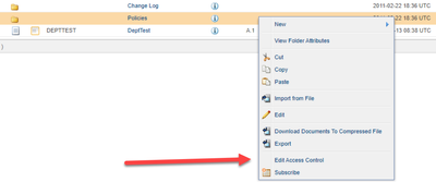

What you have displayed are AdHoc access control rules.
You set such a rule for a folder or an object. For the object, it is not assigned for a given state this is a general access rule set for all object states.
These ad-hoc rules are going in addition to regular ACL (defined with an object, a role, a state, and a set of permissions). You can grant access using these rules but you can't remove access against regular rules.
If you implement such a rule you need to have set very restrictive regular rules as you can only grant permissions with it.
This is not like hiding a command with profiles.
The out of the box product  and library templates are not containing such ad-hoc rule, what you see has been configured.
UI setting to set such permissions:
You can set them in the UI here:AdHoc acl.png
