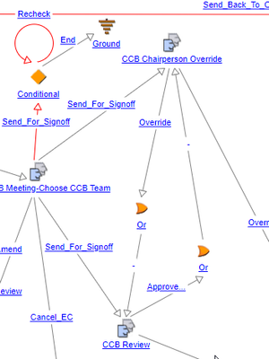

It may not need to be as complex as my example but from the "Choose CCB Team" step, when they send for signoff, it goes in many directions. The "CCB Review" task does not have send notifications checked. My send occurs from the conditional towards the top but you could just as easily do this from a transition on the task itself. It would not work in my case for other reasons.
So in the conditional, I call:
customization.workflow.MyWorkflowProcessHelper.sendNotifications((wt.workflow.engine.WfProcess)self.getObject(),"CCB Review");
This should find all the task instances (WorkItems) with that name at this step and then send a email. You'll need to create your own help class (best practice to externalize code in workflows unless its dirt simple).
