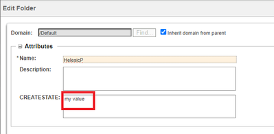

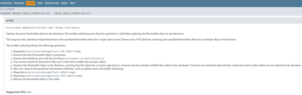

HelesicPetr
(To:AK_10639313)
Hi @AK_10639313
Trust me it has to work 😄
Ok. If the folder exists, then you can not use the Store helper method. So use modify
With store you could see error like this>
Also you could find that Object obj has to be cast to Persistable type
btw I've tested the code now and it works.
PersistableAdapter folderObj = new PersistableAdapter(fold, null, null, null);
folderObj.load("CREATESTATE");
folderObj.set("CREATESTATE", "my value");
Object obj = folderObj.apply();
PersistenceHelper.manager.modify((Persistable) obj);
I updated the iba attribute by my code.
