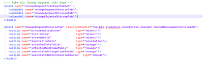

Now I want to have an individual order of the sections on the Details tab like Affected Objects, Attachments, Associated Process Objects, etc for the SCR. And no I don't mean the attributes layout.
I already found the current action model, which is used for all the change request types: changeRequestInfoPageTabSet
And also the section in the ChangeManagement-actionModels.xml
But when I make changes here, it will be changed for the parent Change Request and also all child objects.
I would suggest the next steps for the SCR are to create
1. a action model name="standardChangeRequestDetailsTab" for the order of the single elements
2. a action model name="standardChangeRequestInfoPageTabSet" for the different tabs
But how do I link now the new created standardChangeRequestInfoPageTabSet with the actual SCR Object? And replace the old action model with the new one?

If you define the tabs and tables for your request, add own custom one and add an filter to that actions.
The filter helps you to show your actions(tables) only for your subtype.
PetrH

Hi @NR_9463014
in XML actionModels define the tab and what should be shown in it.
Set a filter in the actionModel for your tab and thats all.
There are also many Examples how to use the filter in a customActions..xml
https://community.ptc.com/t5/Windchill-Customization/How-to-override-ootb-validator-or-is-any-way-to-add-our-own/m-p/934297#M138%3Fsource=search
