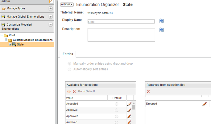

Looking at customizing lifecycle states in a sandbox, adding my own states, I should have access to a "Customize Modeled Enumerations panel" under Site - Utilities - Type and Attribute Management. However, I only see the usual five "Manage,,," panels.

Hi @Zoltán
What Windchill version do you use? this is available on 12.1 +
In the older versions you need to use windchill shell enumcustomize utility

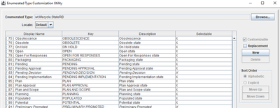

Answering myself, probably via Windchill Shell.... but I don't get the guide in the Help Center then.
  1. Open Windchill shell.
  2. Type enumCustomize. Hit Enter.
  3. Enumerated Type Customization Utility will open.
  4. Browse to <Windchill>\codebase\wt\lifecycle\StateRB.RB.ser and open it

Hi @Zoltán

Aahh, and here I am playing with marbles on 12.0.2.10, looking at the guide for 12.1.2.0.
So it's a new thing then. Gotcha.
